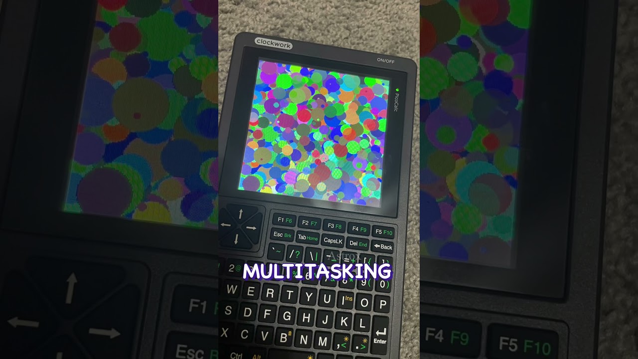

In ~6 hours I will be uploading a new devlog to my Youtube Channel!

New DEVLOG!
