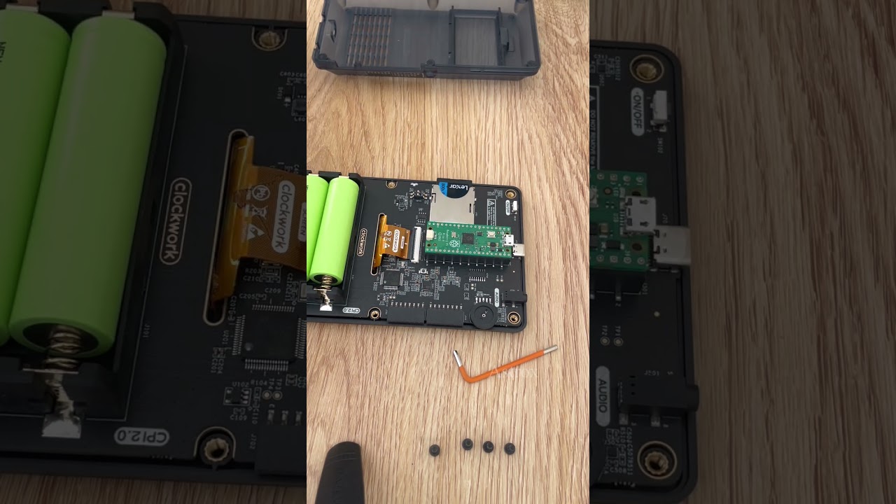

I recieved my Pico 2W board, switching my Pico 1 board with the Pico 2W, was a little bit of a nightmare, but I got it without breaking anything :slight_smile:
New Devlog Coming Out On Saturday
It will basically be me unboxing my Pico 2W, and then yapping about the build error i’m getting for around 30 seconds…
