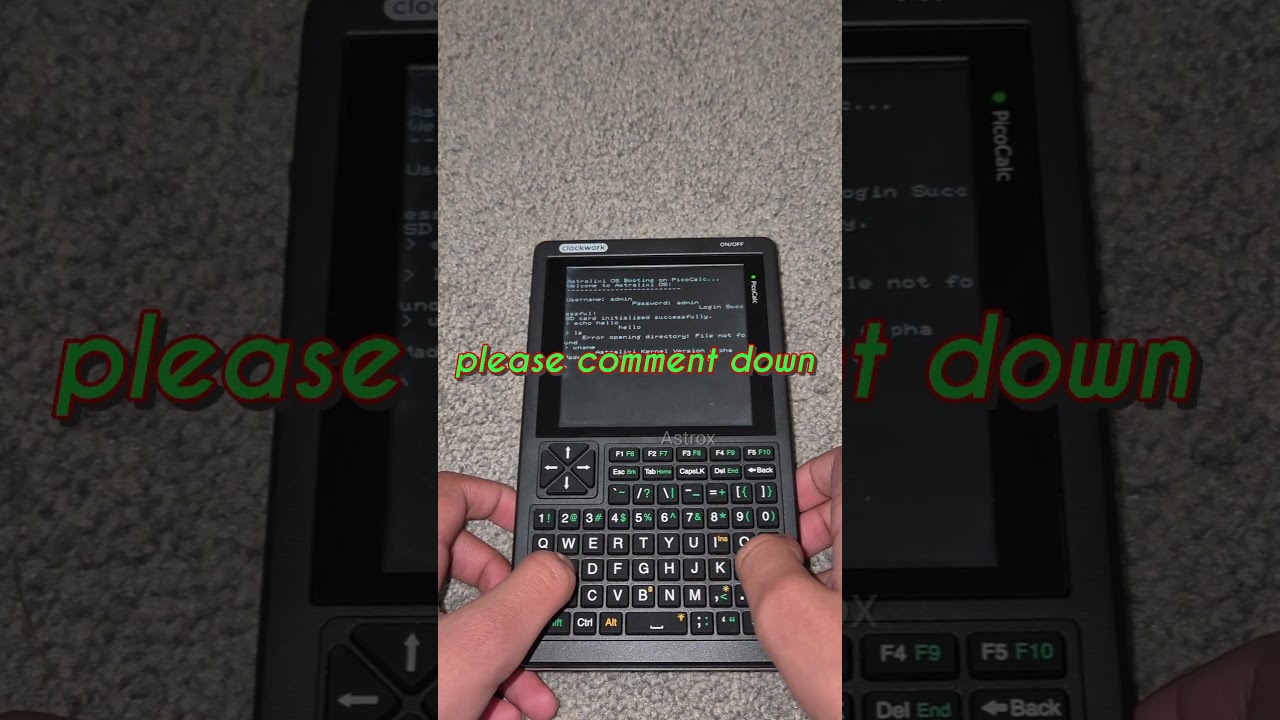

Devlog
Great News Everyone, When I flashed the OS to my PicoCalc, the OS works almost as intended.
Most commands are working, but I still have a few to tweak, especially the ones in relation to file management.
I appreciate the help of the people along the way, especially Blair.
Thanks, Astrox.
I plan on making a devlog short this Sunday, and maybe release version alpha, next saturday.
:slight_smile:
