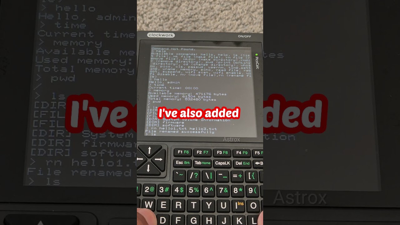

  • mv/rn (move or rename files and directories) [2]

Is this following part of your fat32 driver code for renaming files and directories, if so, what parameters does it require, and how does it work:
fat32_error_t fat32_rename(const char *old_path, const char *new_path)
    if (!old_path || !*old_path || !new_path || !*new_path)
        return FAT32_ERROR_INVALID_PARAMETER;
    if (!fat32_is_ready())
        return mount_status;
    // Find the old entry
    fat32_entry_t entry;
    RETURN_ON_ERROR(find_entry(&entry, old_path));
    // Check if new path already exists
    fat32_entry_t new_entry;
    fat32_error_t result = find_entry(&new_entry, new_path);
    if (result == FAT32_OK)
        return FAT32_ERROR_FILE_EXISTS; // New path already exists
    else if (result != FAT32_ERROR_FILE_NOT_FOUND)
        return result; // Other error
    // Rename by deleting the old entry and creating a new one with the same start cluster
    RETURN_ON_ERROR(unlink_entry(&entry));
    RETURN_ON_ERROR(link_entry(&entry, new_path));
    return FAT32_OK;
Looks like I missed that function in the documentation! Here is the entry:
fat32_rename
Renames or moves a file or directory.
Parameters
  • old_path – the current path of the file or directory
  • new_path – the new path for the file or directory
Thanks for catching that.
Thanks, is there anything for moving file/directories?
a move is just a rename in a different part of the path
