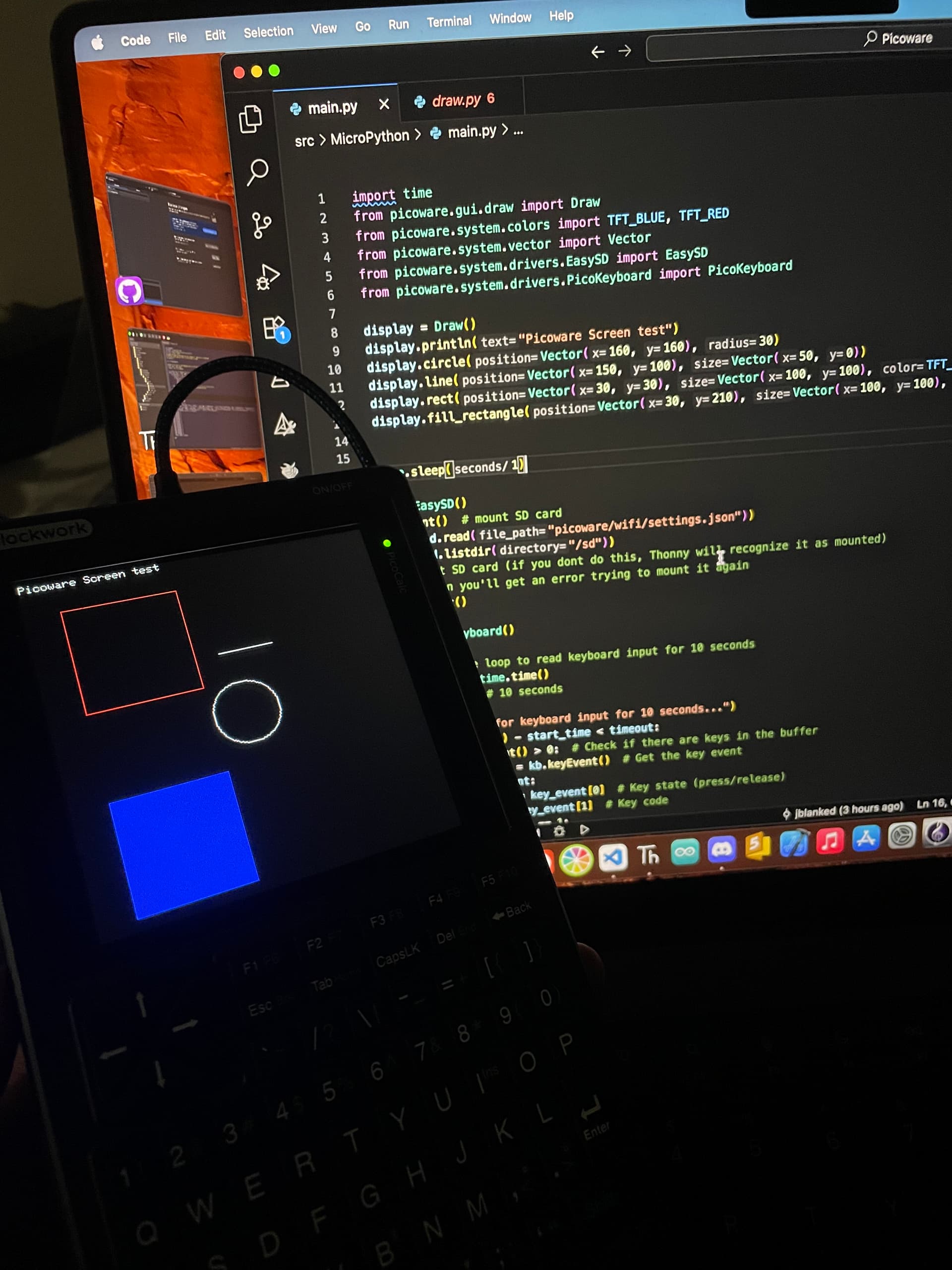

Great day!! I was working on a few work projects since I lasted posted.
I just started on micropython support! Thanks for filling out the poll
I actually created some libraries for the Pico W and TFT screen earlier this year (RaspberryPi/Pico W/Libraries/MicroPython at main · jblanked/RaspberryPi · GitHub) so it shouldn’t be long until Picoware is functional in micropython
Thanks for your support and patience!!
Great progress today
Tomorrow I’ll work on the GUI, which should be straightforward since I can merge most of the classes from the Circuit Python version
