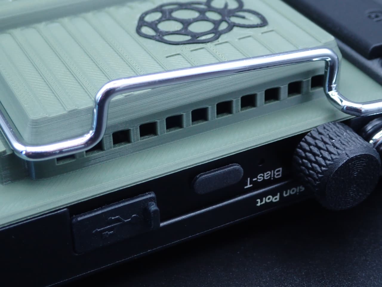

The rear panel and antenna mount were customized based on publicly available 3D data.
Would like to express our sincere gratitude to those who created and shared this data.
The fan is switched on and off by a thermostat attached to the heat sink.
that thermostat is a smart idea, do you have a link to that one?
The thermostat used is a KSD9700 normally open (NO)/45C model.
It is normally off, turns on at 45±5°C, and turns off when the temperature falls below approximately 33°C.
For example, the following seller is available on AliExpress.(I purchased it on Amazon.JP.)
https://ja.aliexpress.com/item/1005005689214002.html
