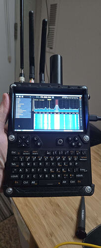

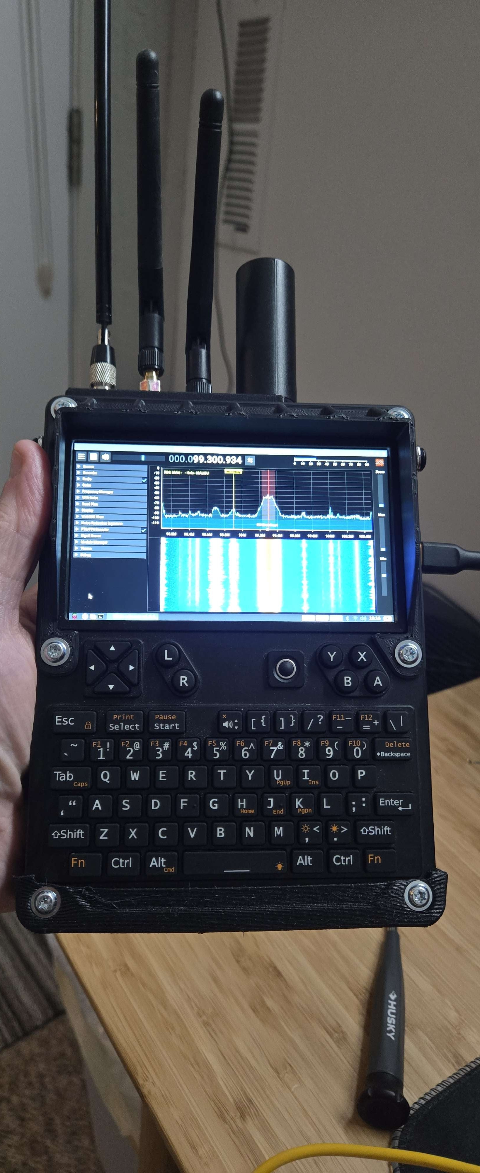

Please excuse the beginner question. Since Trixie unfortunately doesn’t output any audio, I downloaded SDR++brown. However, I seem unable to get it to work. I get the error message below: (Invalid file). I’m using the SDR-RTL V4 stick.
If you’re using Trixie you’ll need to add an audio sink. On the left side scroll down to Module Manager . At the bottom of Module Manager type audio and select linux_pulseaudio_sink then click the + symbol. Then add the audio sink in the Sinks menu on the left side back up towards the top.
You mean SDR++ brown, right? That one doesn’t even start. Or does it work with the original SDR++ now?
what are you meaning by trixie get no audio output? no audio at all or just in sdr++ and sdr++ brown? that audio fix is for sdr++ and sdr++ brown.
if you downloaded it from somewhere else i couldn’t tell you whats wrong. i do have sdr++ brown compiled in my repo for the uconsole. sudo apt install sdrpp-brown
I’m not getting any audio in SDR++. And I can’t get SDR++ brown to start.
How did you install SDR++ brown?
Did that audio fix work for SDR++?
I got it from the page below. I’ll test your version from your repo tomorrow. And I’m sure it will work! :wink:
They don’t have any arm Linux releases so unless you compile it, it won’t work. Try mine tomorrow. Feel free to reach out if you need anymore help.
The audio fix didn’t work with SDR++. The sink option doesn’t even appear there. With your SDR++brown, I was able to adjust the sink using “audio”. Thanks again for your help. I see I still have a lot to learn…
