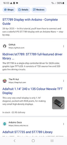

I don’t understand – you’re not using PicoSDK or existing code from clockworkpi (as a reference at least)?
not a popular display?
Yes it will help you. For more information, though, you should look at an actual ST7365P driver. I recommend you look at the driver in extra/common/st7365p_8_common.fs in the picocalc-devel branch of the zeptoforth source tree. Note that this driver uses an RGB332 framebuffer which it translates when it updates the display to RGB565.
For what it’s worth, we’re actually using ST7796S (in portrait mode) for PicoMite/WebMite. that display type was added to the final release of upstream PicoMite and we found the display updates were faster than using the previous display type so I switched to that.
From what I’ve read, it sounds like there are a ton of very similar displays that are all copies of each other and will mostly work with the same code, though some have certain features lacking in others, and they might actually work better if you can figure out what type of display it is and use a driver meant for that, though it will probably work with some that are “close enough”.
