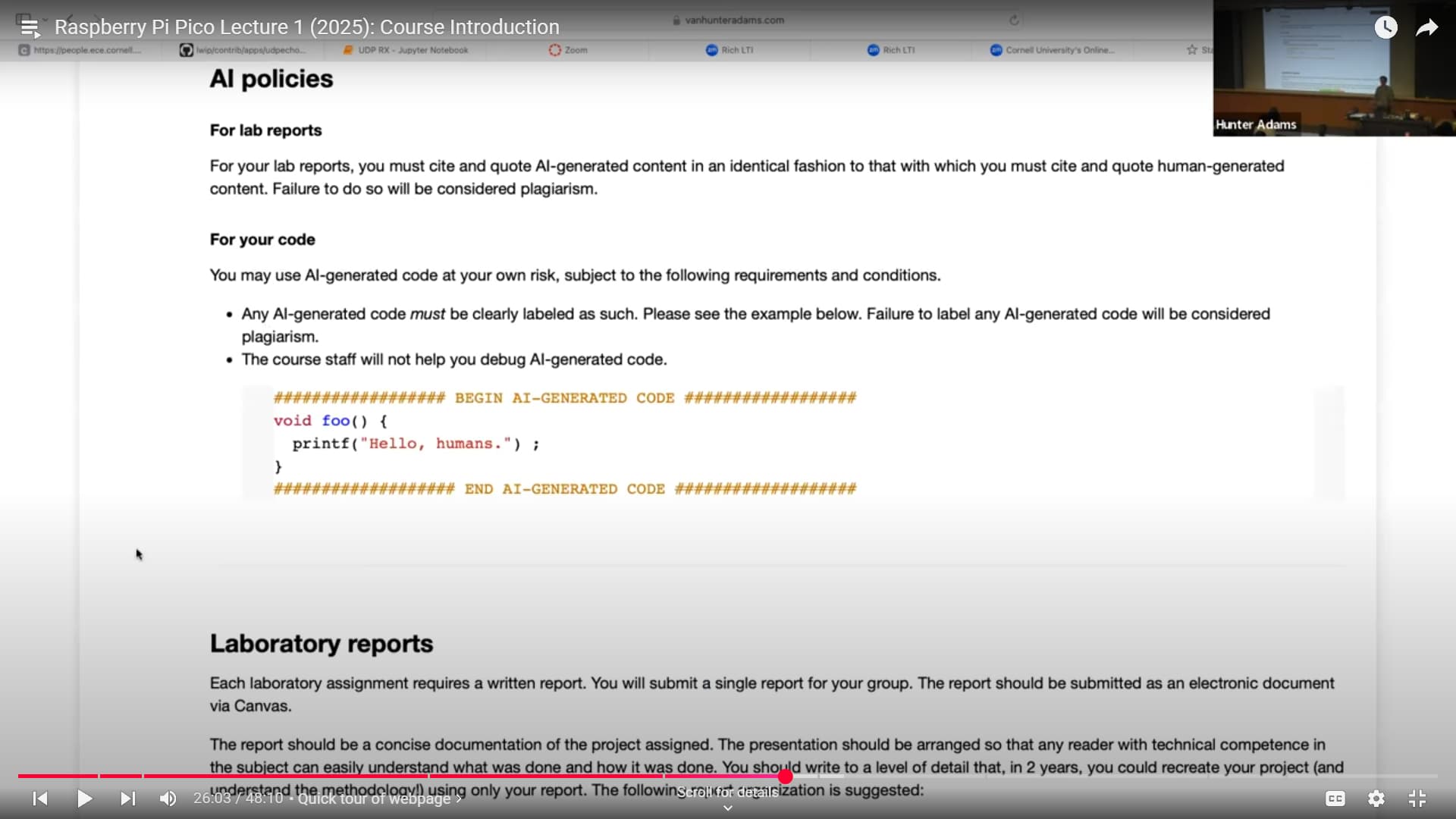

When I was a teaching assistant in graduate school, it was a hassle to look for students copying answers from each other. I actually built a semantic analyser of sorts to help me.
I cannot imagine how hard this job would be today with AI. Hopefully AI can detect AI reasonably well to help.
it might be better if you use it properly, but I’ll never forget this story
