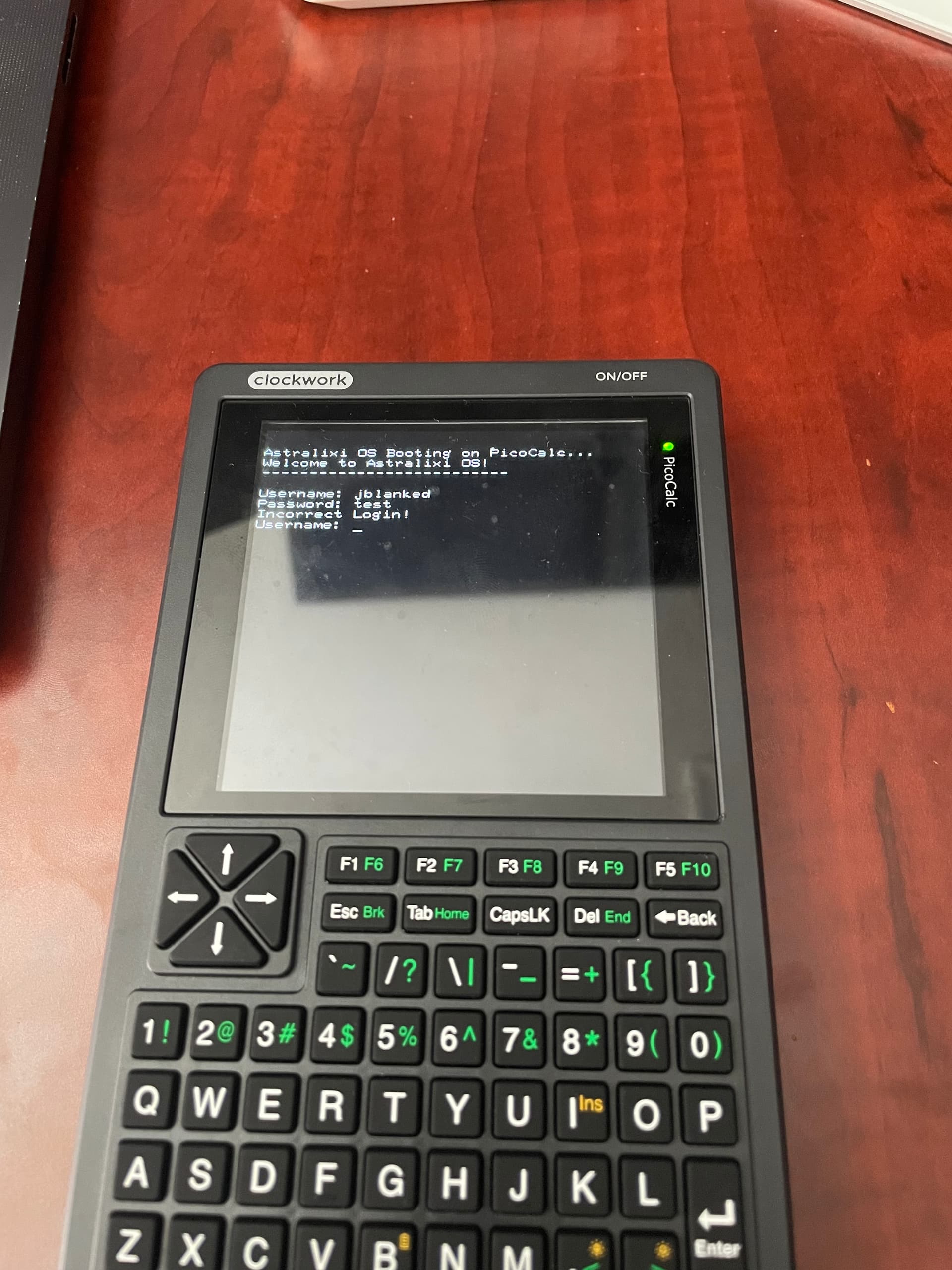

I just gave this a try :fire:
It says login failed?
Is there a registration process and/or are credentials saved on the SD card or a server?
I again recommend open sourcing your project… I’m not used to just downloading/flashing files (even to my IoT devices) without knowing what it (generally) contains.
My WiFi wasn’t connected, so I’m not too worried, and I’m not saying you would put malware or anything like that, but some people may find it a bit odd or worrisome.
@jblanked I forgot to tell everyone, username is admin password is also admin

That doesn’t answer the important question above: where the ids are saved?
We hope they’re saved in a hashed version at least!

The credentials are both currently admin and admin by default, as I said in the short, even if you change them, the next time you boot the PicoCalc up, they will both reset. They are saved as a runtime variable, I will make it save to a hashed file in Version BETA
