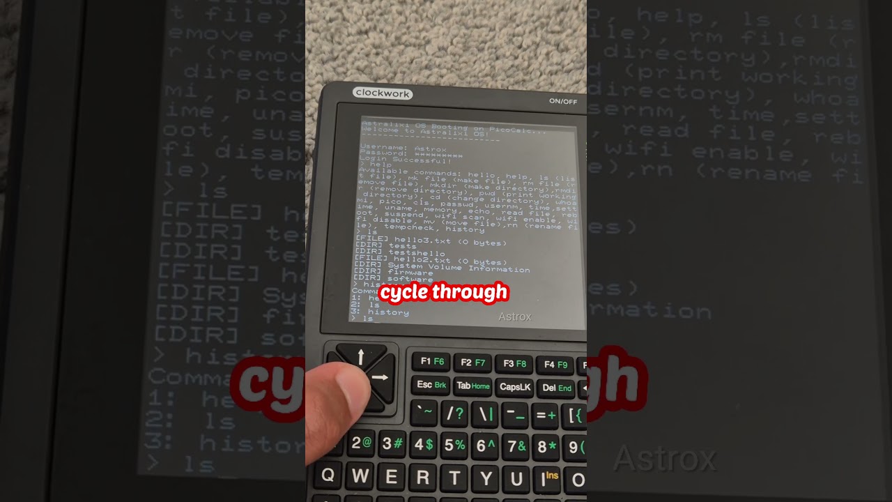

Help Needed Urgently for History Cycling
History Cycling is when your on the command line, and you use the up and down arrow to cycle through your most recently used commands, but in my os’s case, you have to use shift with the up/down arrow.

Accroding to the source code of the keyboard firmware
https://github.com/clockworkpi/PicoCalc/blob/master/Code/picocalc_keyboard/keyboard.ino
The firmware deal with modify keys like alt and shift itself and the capslock status as well.
It will send you a page up/down scan code when you press shift + up/down.
If your are not going to modify the keyboard firmware to adapt your “OS”
you need to workaround with this FEATURE
I am using Blair’s picocalc-text-starter drivers, and I am using the keyboard.c driver in there.

    } else {
        // Move one entry earlier
        history_cycle_idx = (history_cycle_idx - 1 + MAX_HISTORY) % MAX_HISTORY;
    // Skip over empty entries
    while (history[history_cycle_idx][0] == '\0' &&
           history_cycle_idx != original) {
    // If we went all the way around and found nothing, stop cycling
    if (history[history_cycle_idx][0] == '\0') {
        history_cycle_idx = original;
        return;
    // Clear current line
    while (*idx > 0) {
        display_emit('\b');
        display_emit(' ');
        display_emit('\b');
        (*idx)--;
    strncpy(buffer, history[history_cycle_idx], MAX_COMMAND_LENGTH - 1);
    buffer[MAX_COMMAND_LENGTH - 1] = '\0';
    *idx = strlen(buffer);
    for (int i = 0; i < *idx; i++) {
        display_emit(buffer[i]);
function command_history_cycle_down
// Moves forward (down) through the command history or clears the line at newest
void command_history_cycle_down(char *buffer, int *idx) {
    if (!history_has_entries() || history_cycle_idx == -1) return;
    int original = history_cycle_idx;
    int next_idx = (history_cycle_idx + 1) % MAX_HISTORY;
    // If at or past newest command, clear line
    if (next_idx == history_next_idx || history[next_idx][0] == '\0') {
        while (*idx > 0) {
            display_emit('\b');
            display_emit(' ');
            display_emit('\b');
            (*idx)--;
        buffer[0] = '\0';
        history_cycle_idx = -1;
        return;
    history_cycle_idx = next_idx;
    // Skip empty entries
        history_cycle_idx = (history_cycle_idx + 1) % MAX_HISTORY;
        if (history_cycle_idx == history_next_idx) {
            buffer[0] = '\0';
            while (*idx > 0) {
                display_emit('\b');
                display_emit(' ');
                display_emit('\b');
                (*idx)--;
            return;
    while (*idx > 0) {
        display_emit('\b');
        display_emit(' ');
        display_emit('\b');
        (*idx)--;
function add_to_history
// Add command to history; overwrites oldest if buffer full
void add_to_history(const char *command) {
    if (command[0] == '\0') return; // Do not store empty commands
    strncpy(history[history_next_idx], command, MAX_COMMAND_LENGTH - 1);
    history[history_next_idx][MAX_COMMAND_LENGTH - 1] = '\0'; // Ensure null terminated
    history_next_idx = (history_next_idx + 1) % MAX_HISTORY;
    history_cycle_idx = -1; // Reset cycling position when new command added
Please help, i’ve been working on this same issue for the last 5 days…
