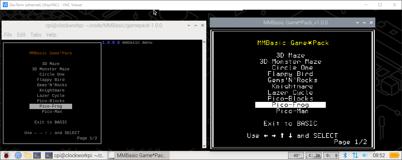

It was super easy to install the latest Linux MMBasic on my Devterm. Just needed to copy over teh aarch64 binary, put it in the path, and then the demo menu launcher worked fine and the demos run. Sound even works fine. Here’s a few screenshots I quickly grabbed from a VNC session. So as-is, it would be fine for starting to do devlopment targeting the PicoCalc, before the actual thing arrives. But it could really shine if the PicoCalc “platform” was one of the options, just to be able to target the 320x320 display size. There’s probably an easy way around that by forcing 320x320 in the program, but I haven’t dug in enough to check. :wink:
Thanks for the pointer to the (up to date) Linux version, @thwill.

My intention is to add OPTION SIMULATE “PicoCalc” to MMB4L but I’ve got a number of plates spinning at the moment so it may well be a couple of months. Most of those programs you’ve looked at will be running using OPTION SIMULATE “PicoMiteVGA” or OPTION SIMULATE “Game*Mite” which both have 320x240 resolutions (one concern I have about the PicoCalc is that the bigger display will require 25% more RAM for a second display buffer which means that certain existing programs may be difficult to get working.) I also need to address the issue that in the current MMB4L the PRINT command always prints to the terminal and you have to use TEXT when writing to the graphics display, whereas by default the PicoMite terminal IS the graphics display.
