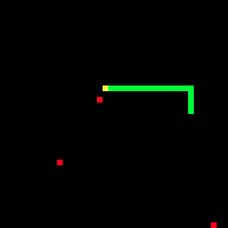

I have put together a “snakes” game for zeptoforth on the PicoCalc. The source code is at:
It requires the graphical terminal emulator and uses the arrow keys for control, along with q for those cowardly sorts who want to exit early and are unwilling to run into themselves.
Here are some screenshots:

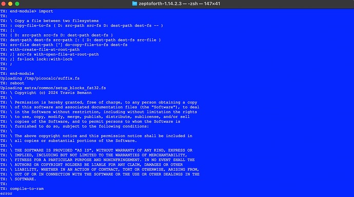

Just tried to run a full install on a Pimoroni Pico Plus 2W.
I did the following:
  • flash_nuke
  • installed kernel (rp2350_16mib/zeptoforth_kernel-1.14.2.3.uf2)
  • ran utils/build_picocalc.sh rp2350_16mib /dev/cu.usbserial-2123430 6x8 graphical pico_plus
  • it gets a long way into the install, but seems to fail soon after the screen on the PicoCalc is enabled (green block cursor appears)
Any idea what I’m doing wrong?
