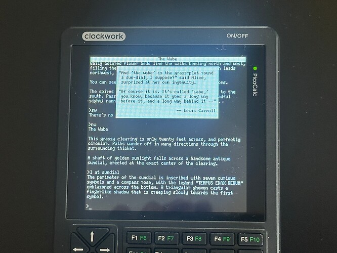

Just in time for the end of the weekend, I have published the v0.3 release.
The big ticket item in the release is the ability to switch to a 64 column display.
I really wanted this so I could eventually play Infocom’s Trinity, their highest-rated story. It requires at least 64 columns to start.
I am personally surprised that I was able to pull this off, with a font that is as readable as the 40-column display. I was able to capture the style of the original font in this more narrow rendition.
Now I am on the fence to whether I prefer 64 columns or the original 40!
Please let me know which you prefer. As always, let me know if you encounter any problems.
This photo isn’t the greatest; I do hope it gets across how 64 columns looks.
