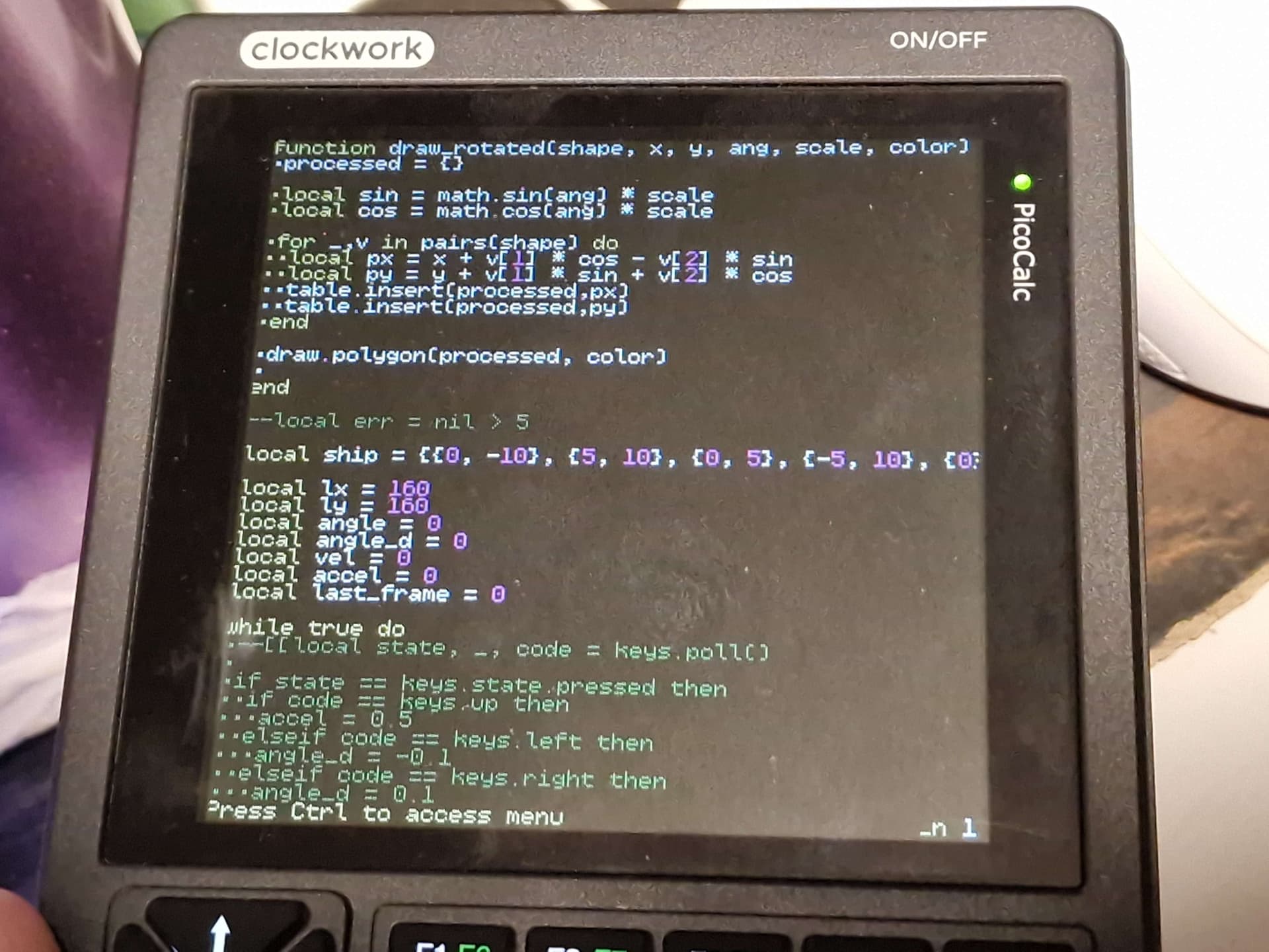

i also plan on making an editor, i was trying to implement enough of computercraft’s API to use its editor written in lua rather than having to implement one on the C side from scratch, unfortunately as soon as i got enough in place for it to run it just blows through the entire free memory, probably because of all the lexer and autocomplete stuff it does :^)
Really nice, I’m glad you find time to improve this project.
here’s a new release, the ComputerCraft editor (slightly modified) now mostly works! Release 0.2 · Lana-chan/picocalc_lua · GitHub
