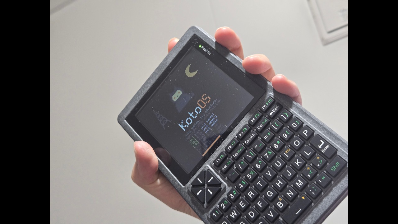

I was able to try out KotoOS on a PicoCalc equipped with a RasPICO 2W.
The PicoCalc has been transformed into an easy-to-use PDA that supports a Japanese-language environment.
While it was possible to achieve a Japanese-language environment by equipping the PicoCalc with a Luckfox Lyra or RasPiZero2, those options involved the hassle of installing an OS and required a long time to boot up after powering on.
(Of course, I realize that one shouldn’t simply compare them directly or judge which is superior.)
KotoOS greatly expands the potential of the PicoCalc.
Thank you for such wonderful development work.
