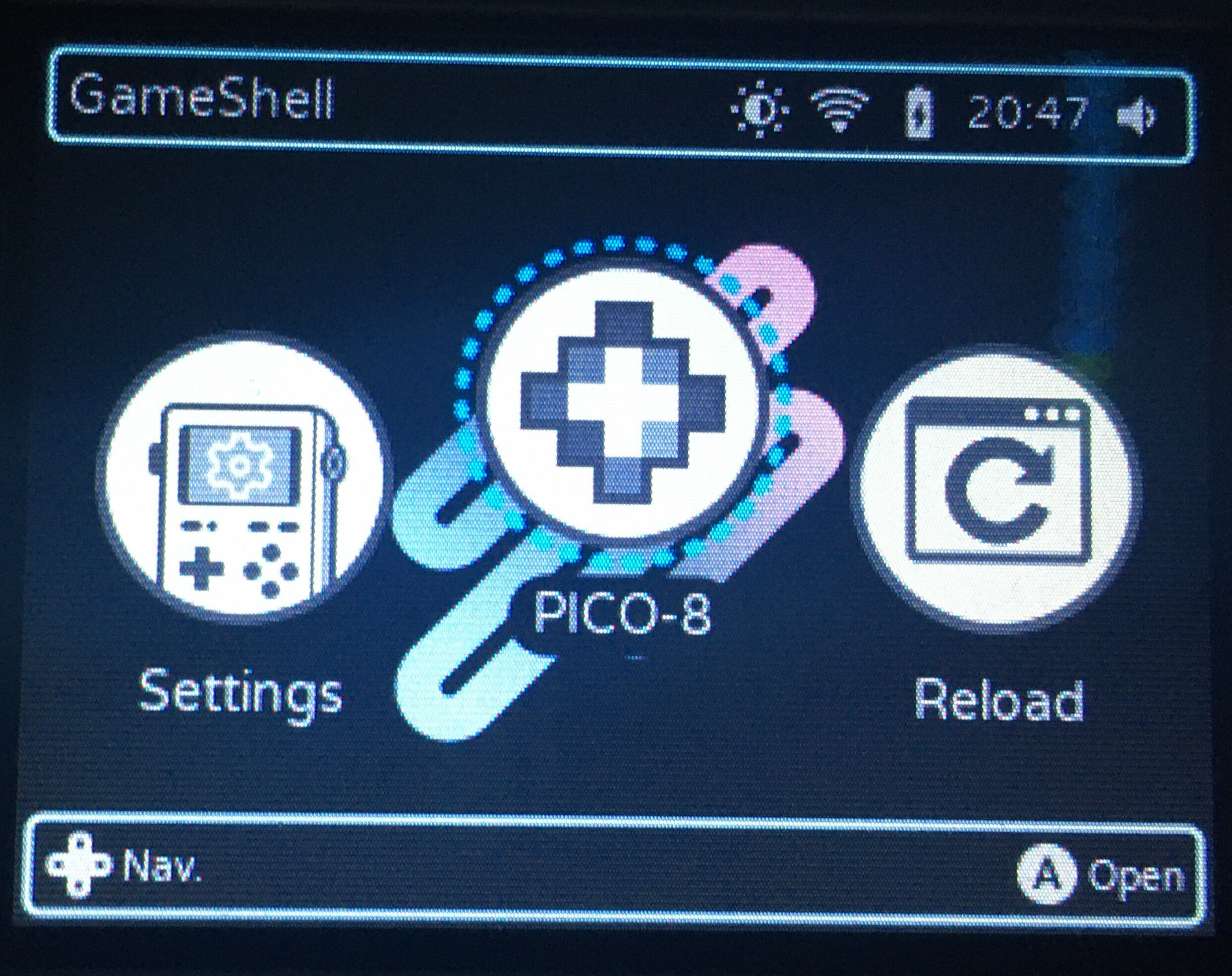

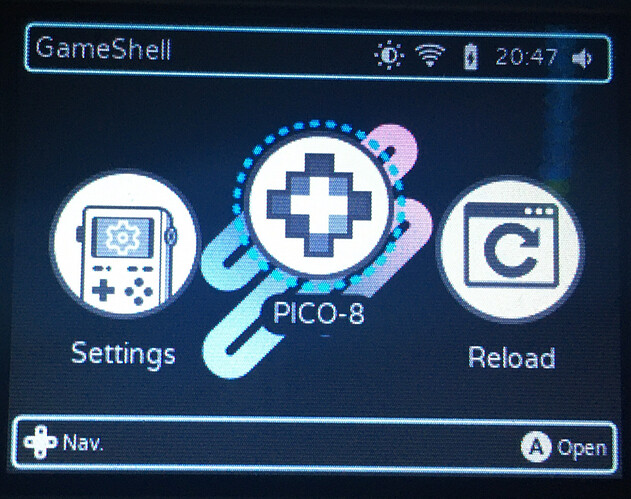

Another thing, on the GameShell the launcher relies on the system’s stock procedure to launch itself, not sure if that’s changed on the DEOT image. I’m thinking about it because a screen like @Metonym 's is very strange if the GameShell doesn’t try repeatedly to boot the launcher and stays idle like that.

most likely a problem with the way DEOT boots, as it’s definitely different than on the stock image (the glitching effect is one thing you can easily point out)
i also flashed the stock image and installed the launcher the same way i did on DEOT, and it works perfectly
Alright, I don’t know how the DEOT image boots, but should be easy to correctly configure the initial startup scripts, on github there’s a bit of documentation on how to manually start the launcher in the Other Linux Devices section.
The screen glitch “should” be resolved in a hot fix I posted. That’s to do with basically changing the kernel.
Perhaps the kernel is to blame, with a different tclock divider? That could be conflicting with Godot.
Other than that, I also change the window manager, but that shouldn’t be a problem if you’re using Godot.
The only other thing I can think of is that I have added a startup sound. I don’t know if that would mess with startup, if it needs to wait for the file to fully be played.
