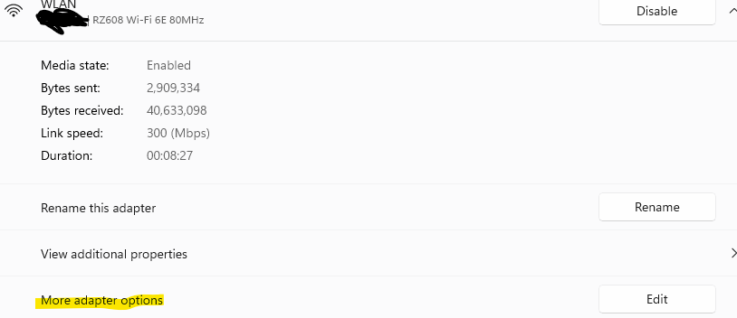

Now you have to do serveral things:
Go to more adapter options:

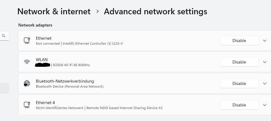

And activate sharing for Ethernet 4:
For some strange reasons Windows only allows internet Address 192.168.137.1 to be the network.
So you have to set your Pico ip to something in this network: eg.: 192.168.137.10
I am not sure if you need to activate all the services in the Settings:

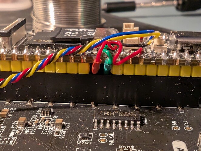

My version of the sound fix, for both L and R channels (pins 4 and 5)
I also have an RTC attached to the I2C bus.

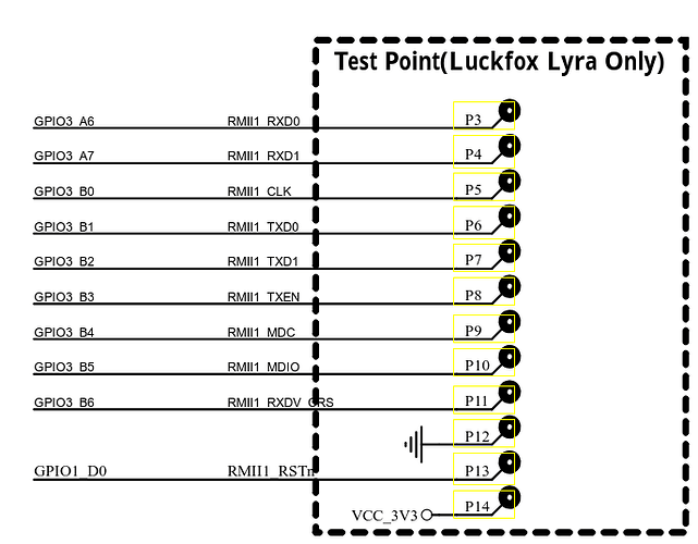

if any GPIO will work, then you could use the GPIO pads on the underside of the lyra board:
- (found in the Lyra schematic https://files.luckfox.com/wiki/Luckfox/RK3506/PDF/Luckfox%20Lyra%26Luckfox%20Lyra%20Plus%20SCH.pdf).
You probably also do not need to wire the CS pin, since there is nothing else on this bus you could just tie it to GND. I’m going to try using B2, B3, B4, B5, B6, and D0. The other pins appear to be an I2S bus I’d like to experiment with later.
