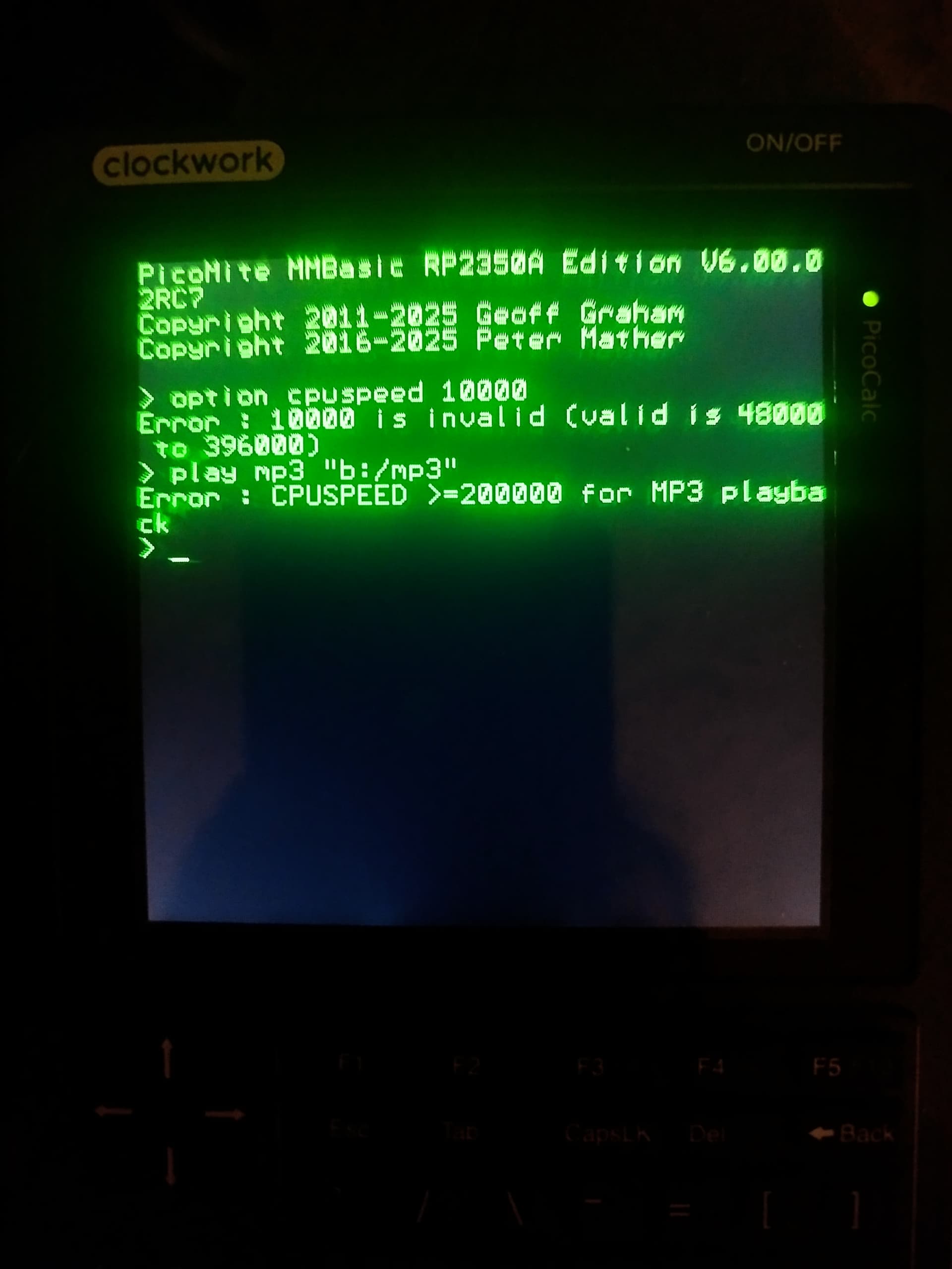

How do you set the CPUSPEED higher than 252000? When I try with WebMite MMBasic, I get an error saying the maximum is 252000. Also, why do you set the CPUSPEED to 200000 before playing an MP3? The Raspberry Pi website says speeds higher than 260000 will damage the WiFi/Bluetooth interface chip.
Ooh, I think it is because they are talking about the 2040, I have the 2350, and for playing mp3, you must set to minimum 200000, It is all on the manual,
