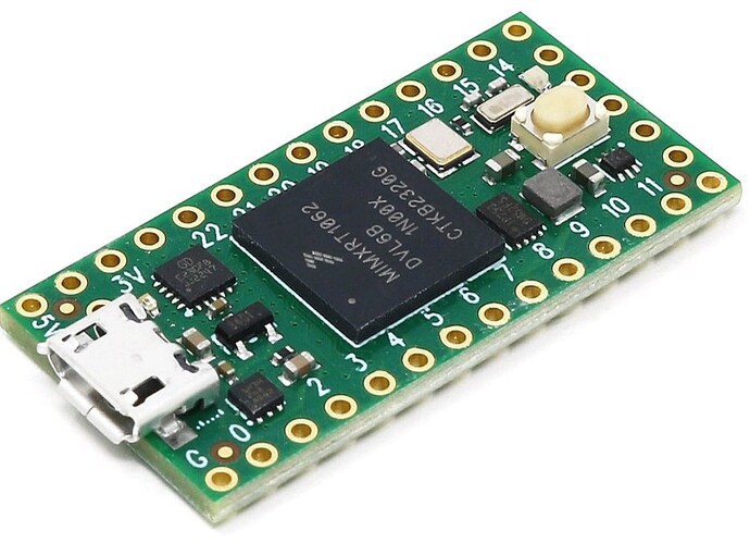

Hmmmm Teensy 4.0 and 4.1… 600Mhz (overclockable too) with built in RTC !
UPDATE…
First look at pinouts and its clear very few if any pins align with Pico hence it will need at least an adapter board underneath to juggle them around and also give the standard 40 pin footprint.

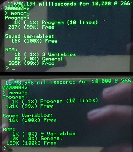

Interesting figure for MMBasic on Pico2 vs Pico !.. 1.18x faster at same clock speed (first post updated). I expected more. Benchmark includes graphics commands so display limits may handicap basic number crunching. Should be able to safely overclock further than Pico though, currently 300Mhz. Will connect a thermocouple to the Pico2 processor asap and consider a heatsink.

Is the source code for the benchmark available somewhere?
