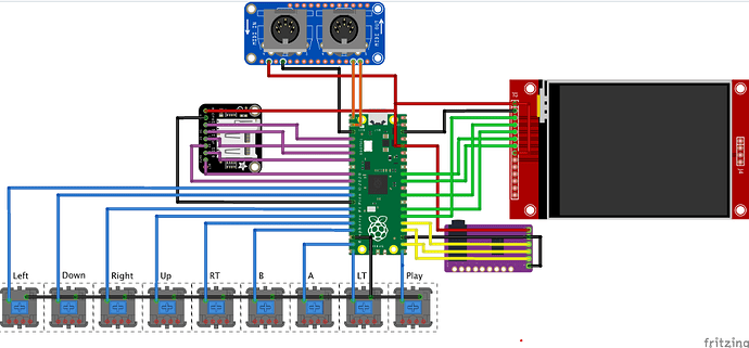

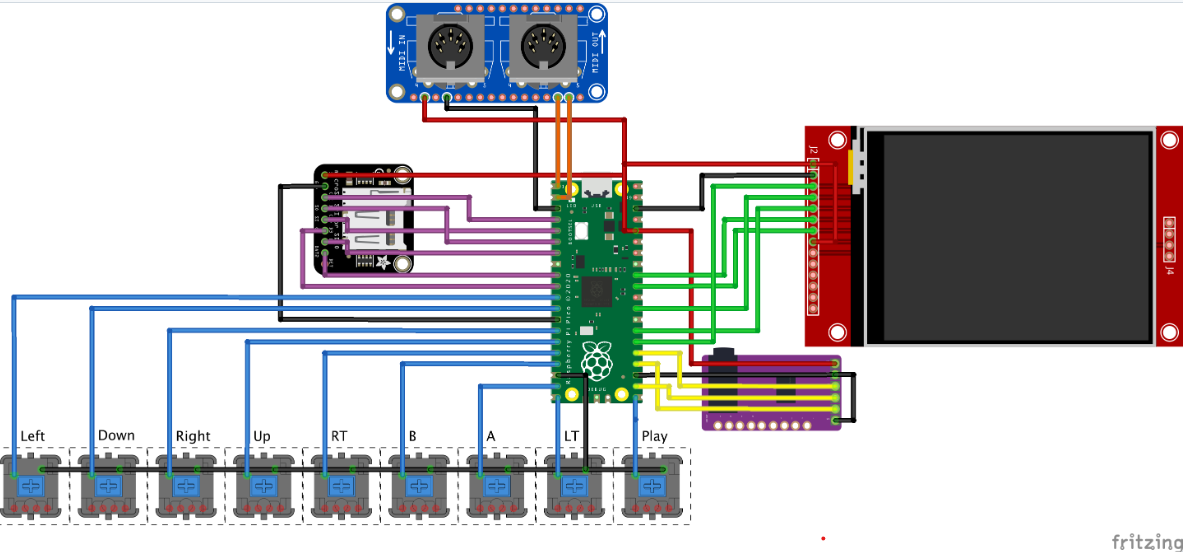

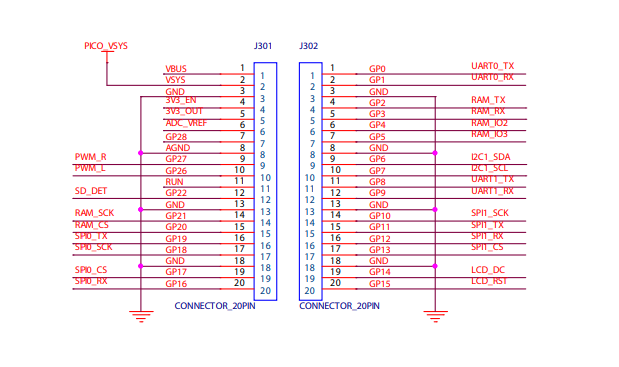

If you look at the schematics:
PicoTracker:
PicoCalc:( Schematic is mirrored)
As I read this:
  • There using the SPI ports for the Display is used in the Picotracker Software for the Keys.
  • The Audio Interface is SPI and not PWM. So this have to changed. I am afraid this is outside of my capabilities
  • PicoTracker Audio SPI is there where the SDCARD is on the the Picocalc.
  • PicoTracker SD Card is where the Picocalc PSRam is
I am not saying it is impossible, but it is definitely for me. It means a complete rewrite of the original code.
