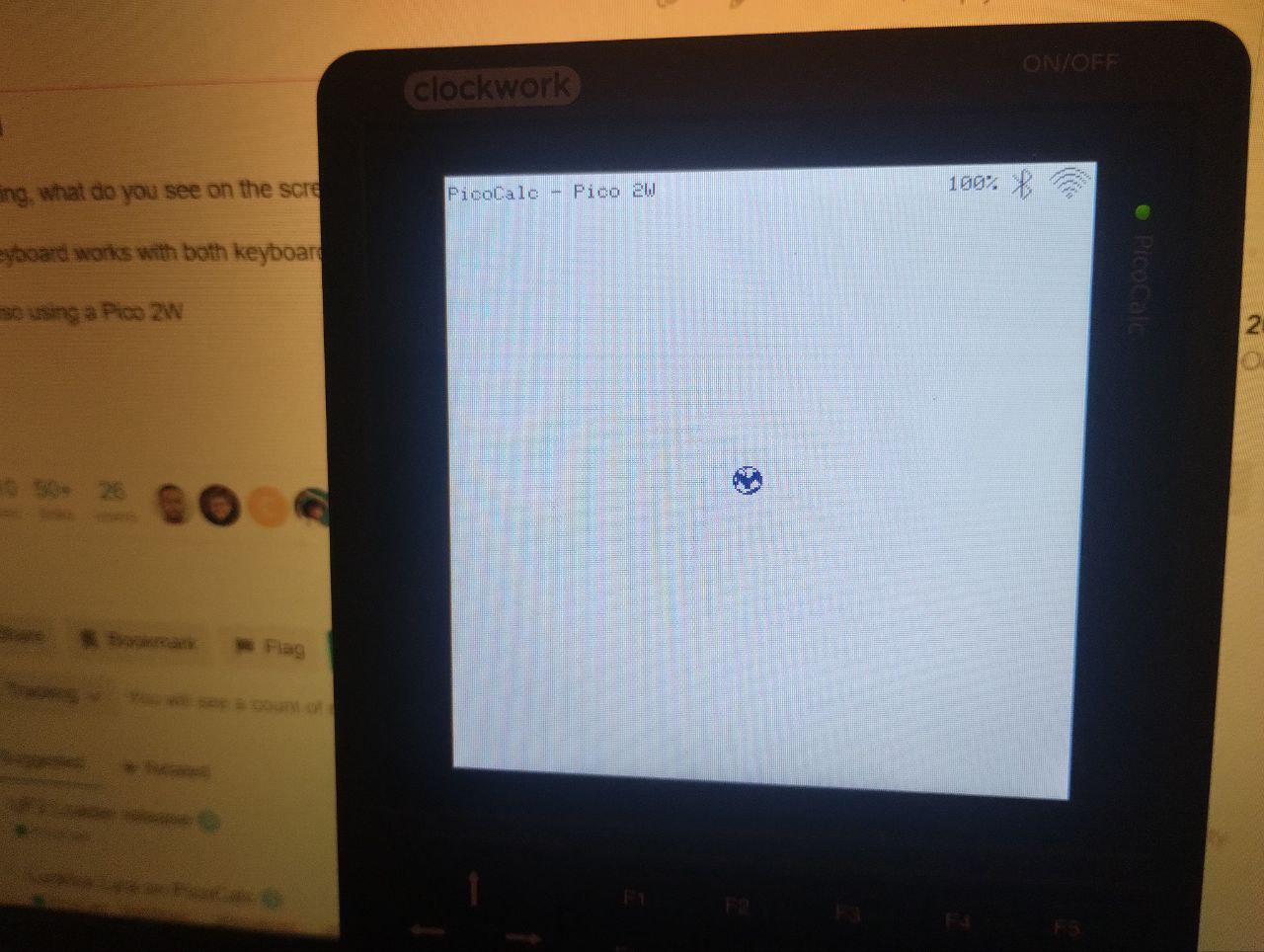

That the program is not responding after loading the initial screen.
The version before running fine.
Must note that my PicoCalc have no updated keyboard SW,
which may be the source of trouble.
Interesting, what do you see on the screen initially?
The keyboard works with both keyboard firmwares
I’m also using a Pico 2W
only this…
What happens when you press Up or Enter?
Nothing….
Only the point in the middle changing the colors, dark blue, blue, red….
Hmmm I suggest upgrading to BIOS v1.4 then. Im assuming Blair’s latest changes to the Starter Kit don’t work with BIOS v1.2

just for test, have reloaded the v1.4.8 MicroPython, that one running OK
I just reproduced the problem you reported. I’m also using the uf2loader. The older version of PicoWare using MicroPython (1.4.8) ran ok under my pico2w, but the newest version (1.4.9) shows the startup screen and then no keyboard keys respond. I had set mine to dark mode under 1.4.8 and the startup screen for 1.4.9 was still in dark mode, so it was apparently reading the config info and using it. The colors for the icon in the middle of the screen cycle, but key input seems to be ignored. The SDK version of 1.4.9 seems to work ok though.

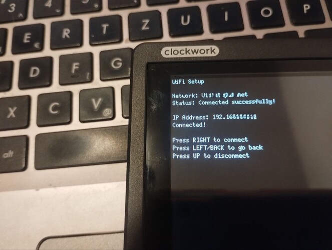

SDK version wi-fi reporting connection and getting the data over the net.

Here last SDK version.
