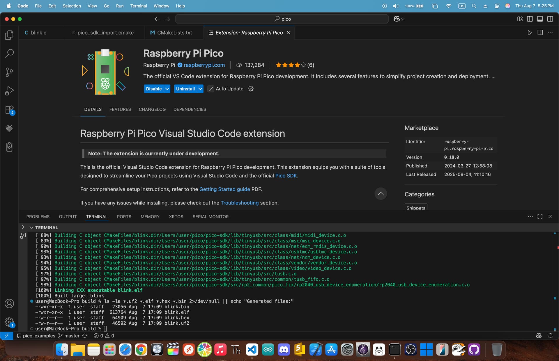

First day using the SDK. I initially thought it was Linux only :sweat_smile: I did an initial build using CLI and it worked well. Now I found a VS Code extension. I’m very excited for this!!
All set!
