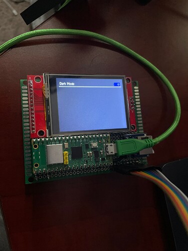

Introducing dark mode ![]()
Users can turn it on and off within the system settings!

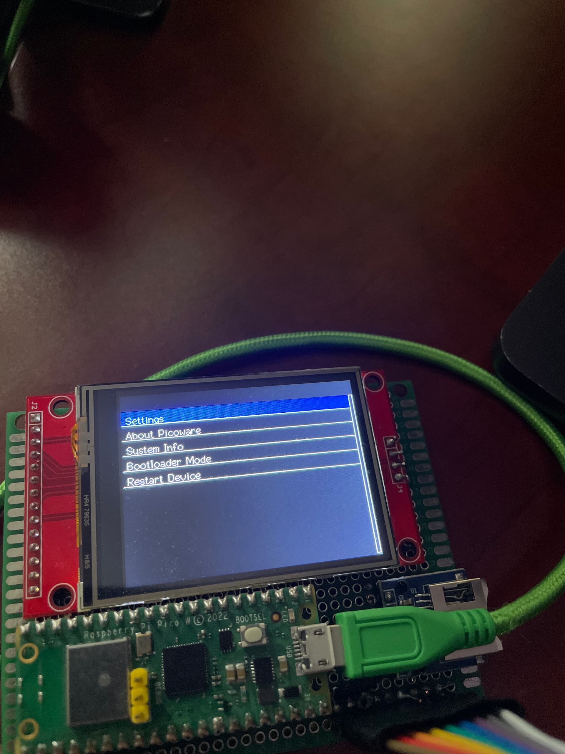

I’m also working on a File Manager (as one of Picoware’s applications) that will list the files from the flash and SD card, and allow users to view and edit them!

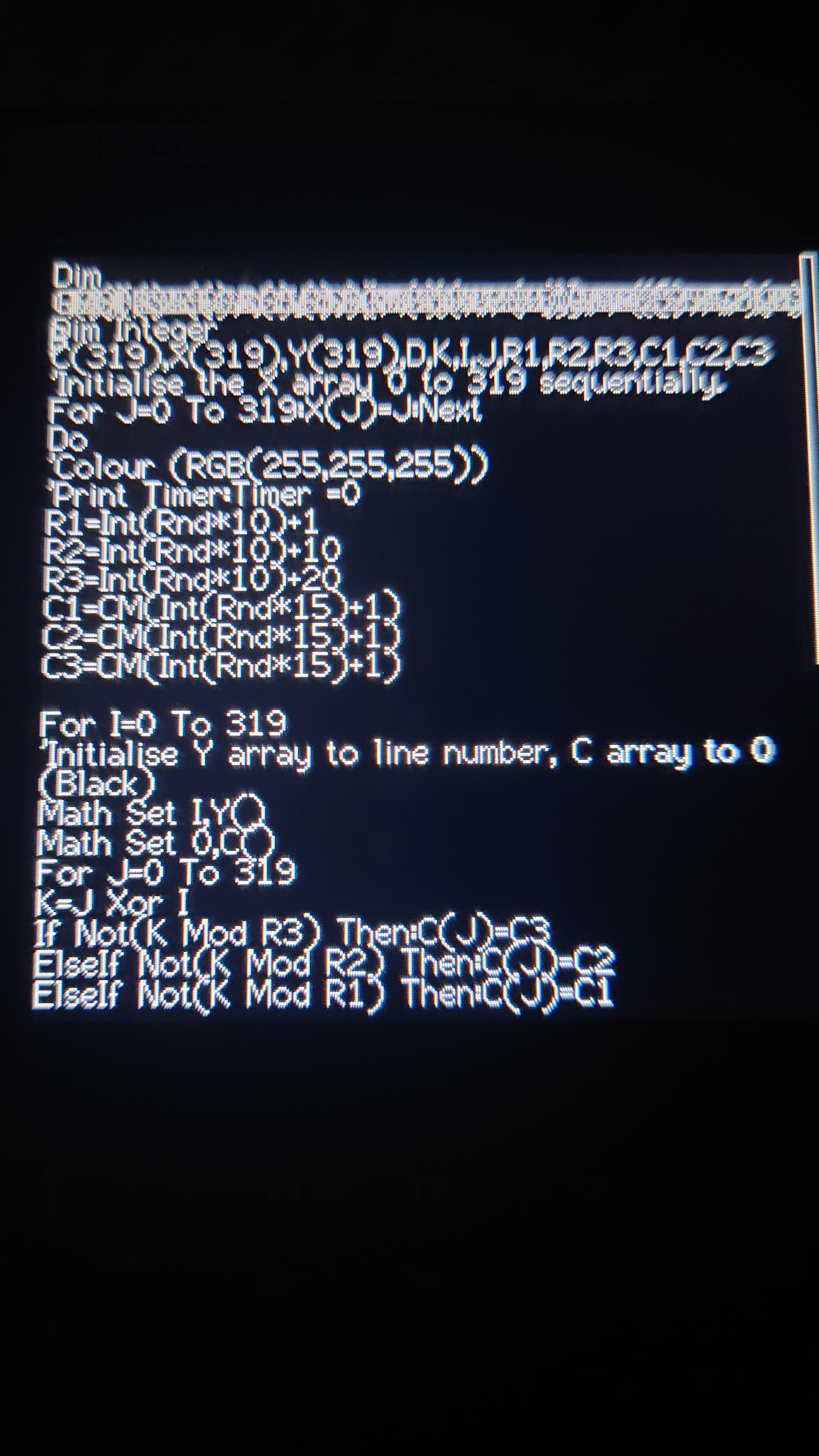

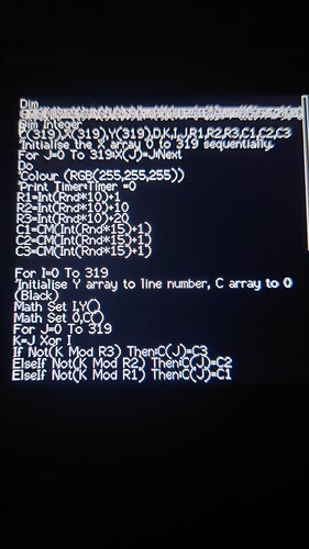

File browser: when viewing text file or .bas file and listing till the end (DOWN key), screen focus jumps to the last symbol in the line. If line is long enough, user cannot see text in the beginning and cannot move to the beginning of thd line. Maybe it’s better to stay at the beginning of the line and list long lines only when RIGHT key is pressed.

The file browser - it works like you described, the only thing i’d suggest to change is to keep cursor at the beginning of the line.

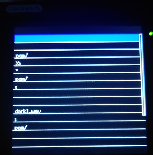

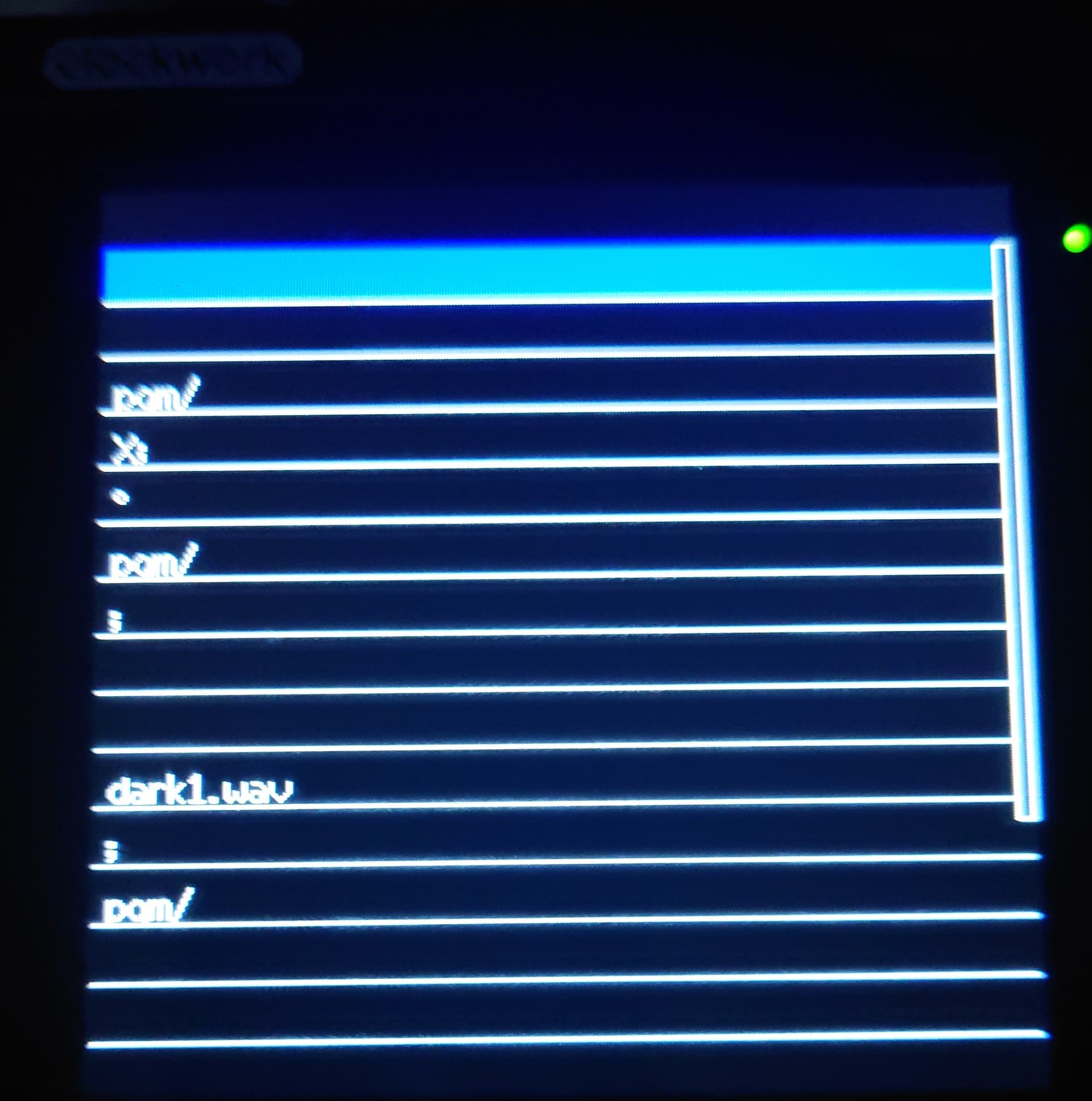

Tested file browser few more times. I launched it right after boot sequence. File list looks like encoding is broken or it seems that cursor is moved to the end of the line and short file names go out of the screen. Then i pressed LEFT key and launched the app again - it showed file list as expected. The same thing can happen if i go into some directory. It opens quite slowly, screen goes dark for a few seconds, there are about 50 *.bas files in the directory.
Opened “.bas file browser - the first line doesn’t look as expected
Ohh I see now, something is definitely up with the File Browser. I’ll update the lists and file viewing. Thanks again for checking it out and reporting issues/leaving feedback/giving suggestions!
