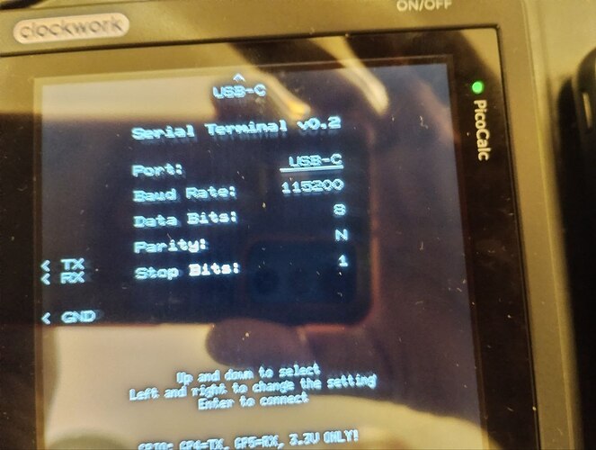

Need some group wisdom here:
Pico 2 & Basic, working ok on the USB C to USB mini cable, Minicom terminal on Ubuntu
The same setup, with additional PS for Pico2, on Pico Calc & Serial Terminal not working.
With above parameters….
Any tip or trick what is wrong ?
The PicoCalc does not work as a computer. It exposes a serial port on the USB cable that you can connect to with minicom, just as the Pico 2 does.
Trying not to get too technically gory, I guess one way to look at it that there is no such thing as a null modem cable for USB.
The only way to connect the two is to use the GPIO pins (on the side of the PicoCalc as shown in the terminal app) and pins 1, 2, 3 on the Pico 2.

This is a pico2w, app loaded via uf2loader.
