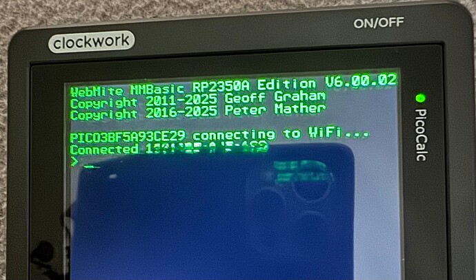

Has anyone else had keyboard disconnect issues with the most recent Webmite or Picomite build on a Pico 2W? That’s the module I use, and I haven’t seen this I2C keyboard problem in quite a while. It was an issue in the earlier builds, but I thought I fixed it with the timing changes some time ago. Before I respond there and verify they’re using the most recent version, I figured I’d do a sanity check here. :slight_smile:
Their post does make me realize something I forgot… I’ve never modified the version number info displayed when the firmware boots up. So there’s currently no way to tell based on that, whether the firmware is the original RC1 that matched with the official RC1 release, or the new “PicoCalc RC1”. For the next release I’ll modify what gets printed on boot so it shows “PicoCalc” in there, and that’s probably something that should be a permanent change for the PicoCalc builds going forward.
I have been using both PicoMite and WebMite pretty much daily since I got both my devices. I have not had any keyboard issues with either since you fixed the problem weeks ago. I am currently using WebMite/PicoMite V6.00.02_PicoCalc_RC1.
Ah, nevermind… I forgot the I2C keyboard error will always happen if just using the PicoCalc as it arrives, even after updating the Pico firmware, because it also needs the 1.2 update to the STM32 BIOS. That’s probably going to be an issue for a lot of new users, since they won’t even be aware there’s a BIOS fix unless they check the forums, or I guess now, happen to see that post in the discord. :frowning:
Maybe Clockwork will start shipping devices with the updated BIOS preinstalled one day.
