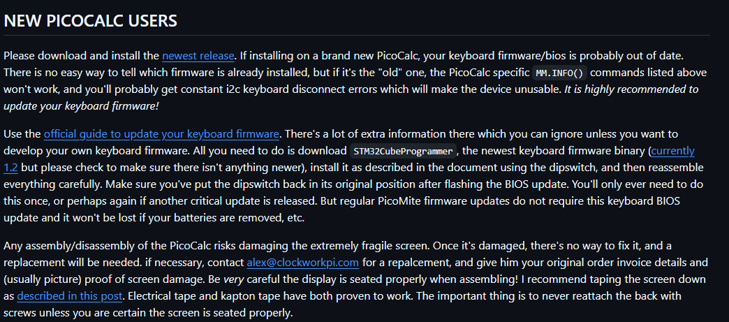

Your post also made me realize I should put more info on the readme on github, so I added a section for new users since unfortunately Clockwork doesn’t really do a good job of letting people know two critical things they need to do when receiving their PicoCalc:
  • update the keyboard BIOS/firmware
  • be extremely careful with the screen
I wasn’t originally planning to write all that, but I wanted to be thorough. Hopefully it helps some new users, and maybe even a few screens will be saved in the process.
Anyhow, thanks! I probably should have added that info a while ago, but this gave me the reason to! :slight_smile:
