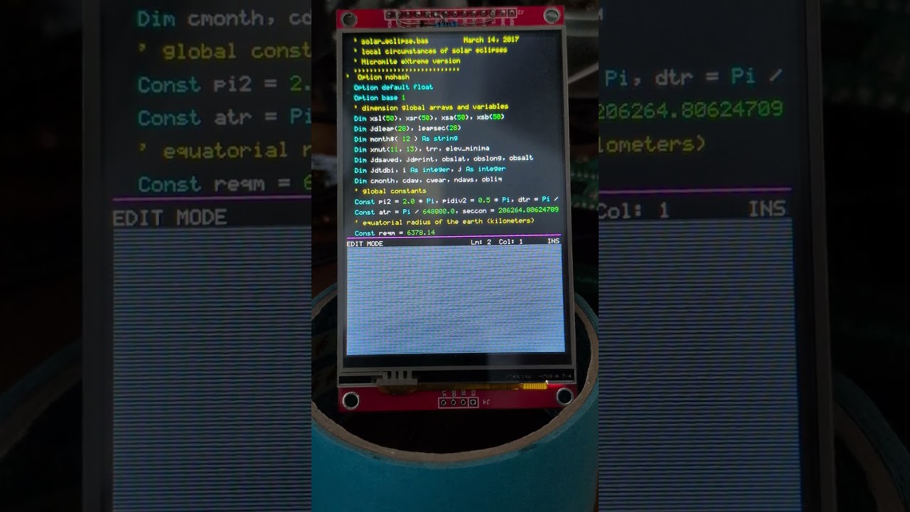

FYI Peter has updated GitHub - UKTailwind/PicoMiteAllVersions: This contains files to build MMbasic to run on both RP2040 and RP2350 with RC19 and he’s even implemented “proper” support for the ILI9488 display in portrait mode with 320x320 resolution.

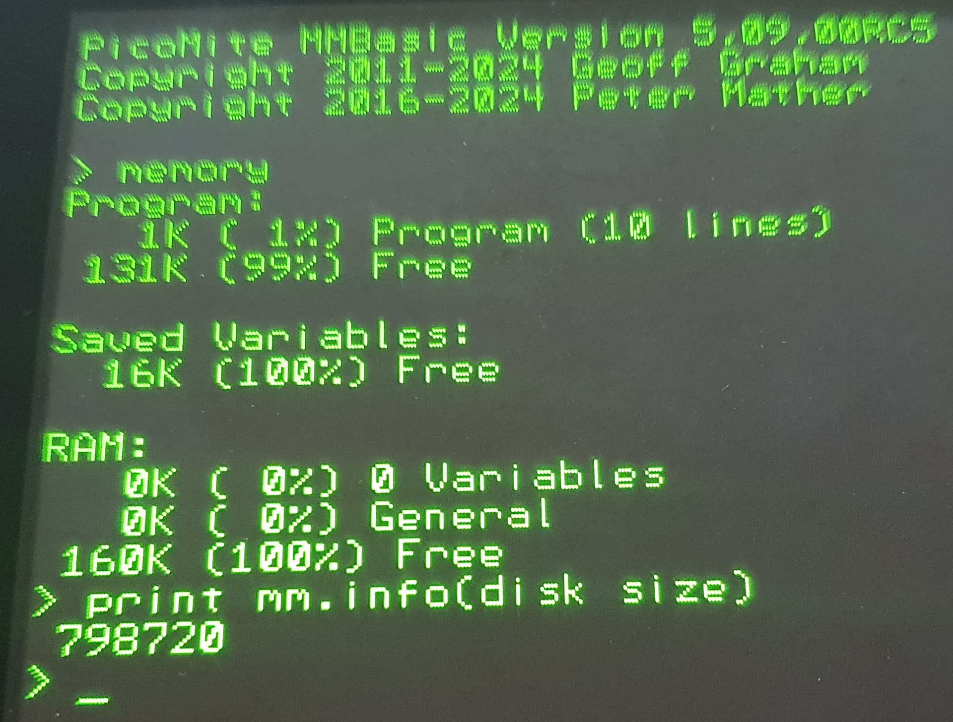

I might be seeing things here but doesn’t the latest build only see 2Mb (2142208 via mm.info(disk size)) of the 4Mb flash on a pico2 ??.

And here is a short video clip that Peter put out (link is also on the TheBackShed forum page referenced above, but I also put it down below for your convenience) that shows how fast scrolling can be on the IL9488 display if implemented properly:
Yes, but I think that’s because the firmware itself resides in flash. The missing amount is about the same size as the firmware itself. And Picomite carves out a little more for the 3 (numbered) user accessible flash slots. It must use a little for saving persistent options too.
The original Pico will have a lot less flash space free. I haven’t swapped mine back in for a long time, but i’d be surprised it it even has 1MB free. It’s probably more like 700KB or so.
Long story short, best to use the SD card for storage for most stuff unless you have a reason not to. :wink:
You’re missing the point here, that command is not for showing free space but total size of the flash chip !. Makes me think a parameter hasn’t been set correctly or maybe a bug. I’ll try the supplied pico for comparison asap…
Yes very odd, here is the supplied pico and old software. Looks like the command is misleading or bugged !. Free space reports 790528.
RC19 code is now available with properly coded hardware scrolling etc my new best friend !!, do you have a coffee donation link ? :smiling_face_with_sunglasses:
I still think the mm.info(disk size) is showing the flash space that is partitioned to be used for the A: drive filesystem.
The flash that the firmware resides in shouldn’t be accessible from the application directly and would not be part of the filesystem. And similarly, the flash storage that PicoMite is using for the 3 slots is not a part of the A: drive and is accessed internally by PicoMite. Same for the little bit it uses for permanent OPTIONS storage.
The mm.info(disk size) command doesn’y imply it’s total flash available on the hardware – it specifically says it’s the flash filesystem. I don’t think there is a command in PicoMite to show total available flash on the hardware.
790k sounds about right for the Pico that comes with the device, and 2MB seems about right for the Pico2, if it’s just the available flash partitioned for use as the A: drive.
