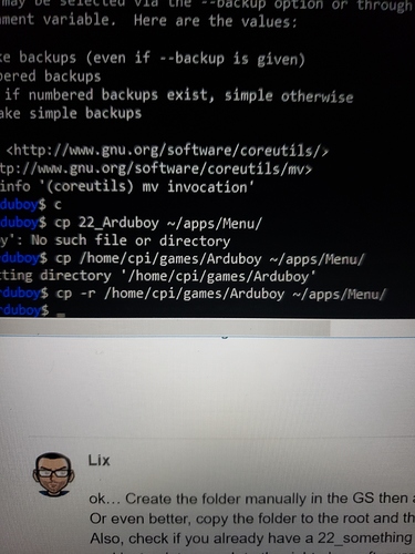

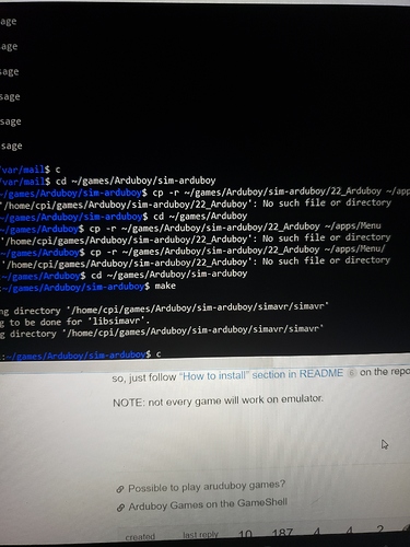

Hey, I made a mistake on the GameShell via command line and ended up having to re-flash the SD card and I’m trying to copy 22_Arduboy onto the gameshell, but the terminal keeps telling me that the file doesn’t exist. I got everything else right and the folder is already installed but the app isn’t showing on the GameShell. Is there anything i’m doing wrong?
Did you try to create the folder manually first through Filezilla and then trying to copy the content inside of it?
No, i tried to rebuild it via command line following your tutorial and ITCactus’s tutorial as well. The Arduboy folder is on my computer but when i try to copy it over to the GameShell i end up getting stuck at that error message.
ok… Create the folder manually in the GS then and just try to copy the content from your PC in it.
Or even better, copy the folder to the root and then use move command to place it where you want it.
Also, check if you already have a 22_something in there… You know you can place it elsewhere too and just point your .sh to the right place afterward.
Cool. I have the 22_Arduboy loaded onto the computer already. I’ll give it a go and let you know the results.
Instead of using ~, enter the full path ex. /home/cpi/…
@Tariq
i already see, that you have “Arduboy” in every place, and NOT an “ArduBoy”.
pay close attention on letter “B” in your dirs - it MUST be uppercase: “ArduBoy”. that tiny difference may cause a lot of issues.
if you use a lowercase “b” on purpose, then do NOT forget to edit “action.config” content in sim-arduboy/22_ArduBoy/.
but it will be better, if you delete the entire folder /home/cpi/games/ArduBoy, and follow tutorial from the very beginning.
