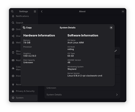

I upgraded from 6.12.y. I downloaded the files from the release and entered the following:
# pacman -U linux-rpi-clockwork-6.16.1-1-aarch64.pkg.tar.xz linux-rpi-clockwork-headers-6.16.1-1-aarch64.pkg.tar.xz
I was prompted and chose to replace the previous linux and linux-headers providers. I verified that my /boot/config.txt had the necessary content, and after a reboot my system worked.
