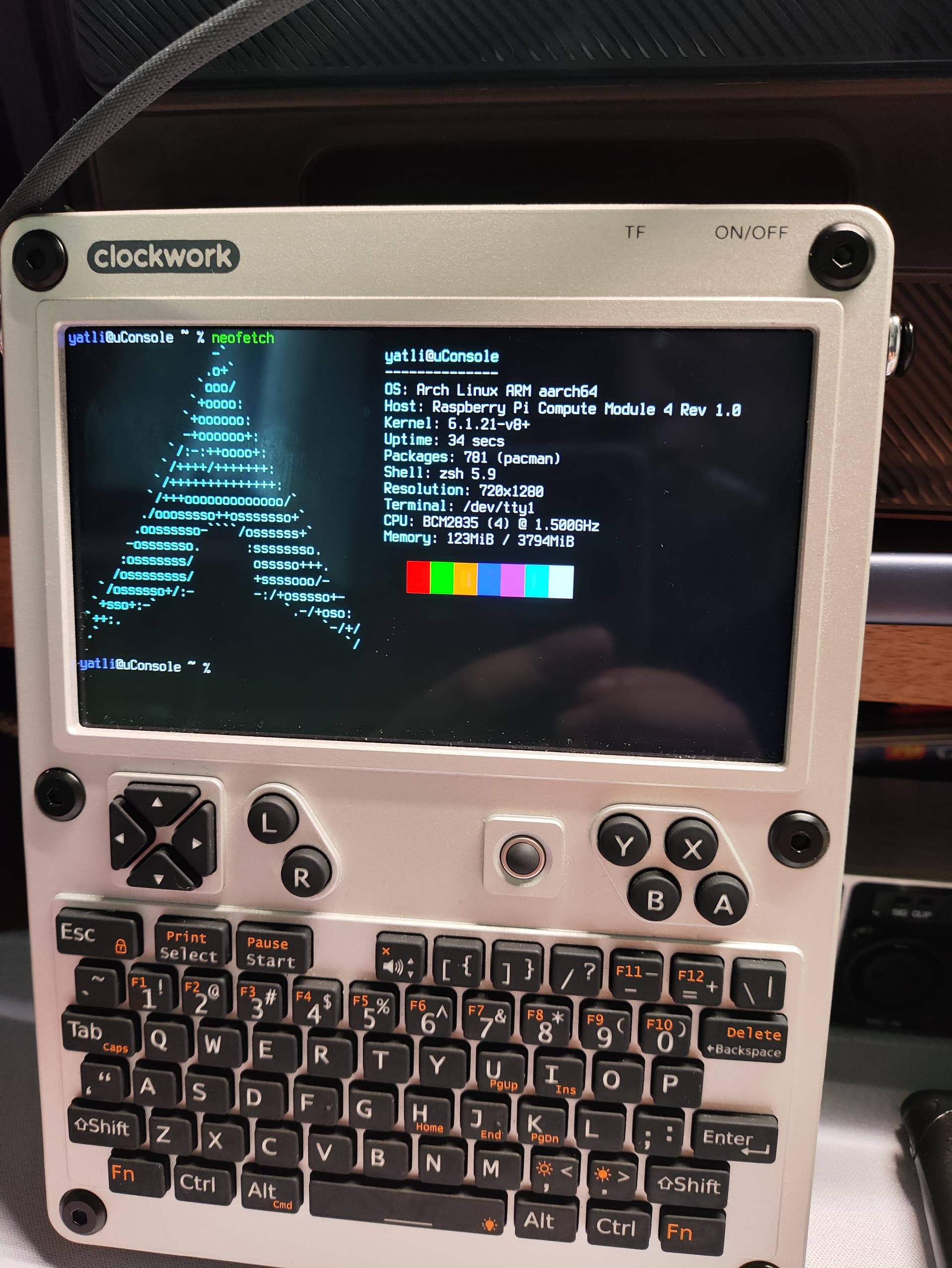

Current status: a test firmware is built.
tl;dr – I maintain the devterm ArchLinuxARM distro, and now I also want to do uConsole-CM4;

Update: actually it boots just fine!
We’ve got a blank display, and wonky power key, but other than that, it boots just fine! This is verified by blind typing to log in and sudo reboot.
sudo systemctl poweroff did not work, probably the same way the power key didn’t – the kernel is not compatible with my axp228 patches. edit: stupid error, axp228 not cutting down power.
Now I can setup a router to have the same SSID and password as remembered by uC and ssh in.

and ssh:
