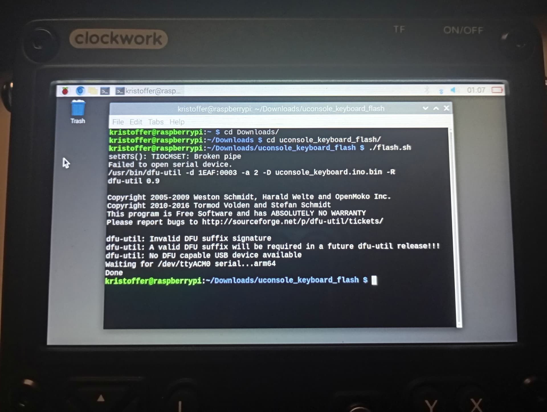

oh no, I was not paying attention and flash this DevTerm keyboard firmware to my new UConsole, and the keyboard and mouse is of cause acting up now. I tried flashing back the UConsole firmware but got this error, anybody can help?
Ok, fat chance you’re gonna get it back without big problem – it still recognizes itself as a “DevTerm”.
Some versions of the DT keyboard firmware will refuse to be flashed once it’s “brought online” – that means, you have ~1 sec on usb plugging in to initiate the flashing process.
First thing to try: completely power it off and back on again. It’s possible to bring it back into flash-happy mode.
If it still doesn’t work, remove the front plate, take it out to a PC and flash it there (within 1sec!). Let us know how it goes, and don’t worry, we’ve got plan B/C/D to say the least.
Thanks for reply, wow I didn’t know the keyboard had it’s own micro usb port for firmware updates. I tried it on another raspberry pi with the keyboard plugged in externally, changed the usb’s address in the flash.sh (from uconsoles github) to match what i found when running lsusb, but it gave me the same errors as in my first post, so no progress. “Failed to open serial device” and “Invalid DFU suffix signature”
Any other ideas?
