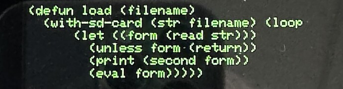

Ok, I’ve found that the file handling works fine, you just need to be careful!
For example, if you define this function, you can load programs from SD-Card.
This makes it possible to copy sample code to the SD card from the uLisp site, and run it. Should save about three hours of careful typing!
For best results, delete any comments and white space at the start of the Lisp file. That’s what broke my first attempts. I need to write a more robust loading function, but this one is simple and mostly works.
