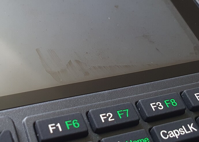

  3. Front protection glass, maybe best doing AFTER CASE BACK IS SCREWED ON (see next section). If you’ve taped the screen down as I have, keep finger prints off the inside of this or you’ll regret it !. I’ll possibly go back in sometime as the inside of my glass has some kind of foggy substance left on there from removal of the self adhesive backing :flushed_face:, thankfully only seen when the display is off.
