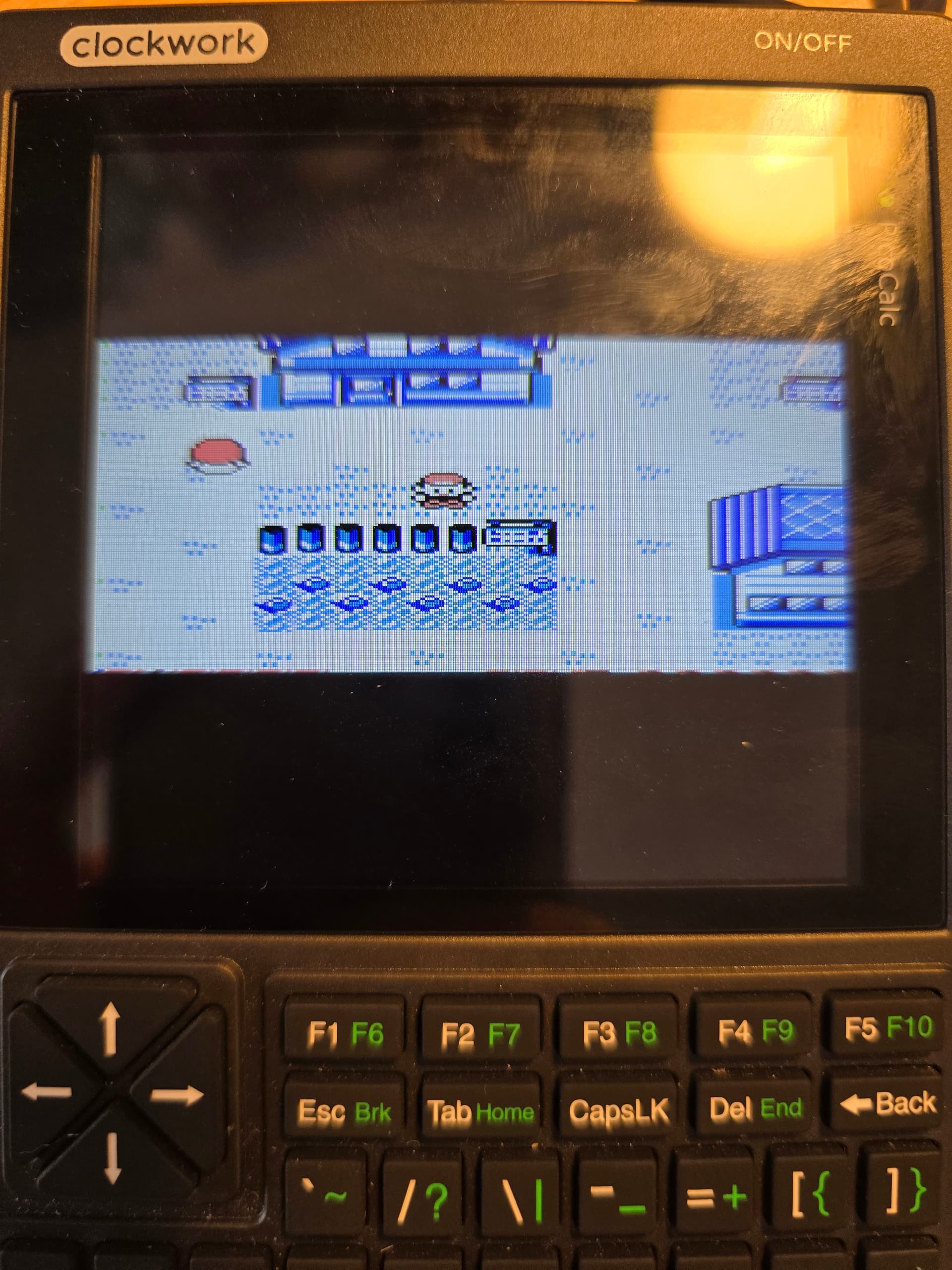

I’ve ported my first Game Boy emulator to the PicoCalc, currently running on a Raspberry Pi Pico W. The emulator is based on a fork of the PocketPico project. It’s functional, but not yet optimized.
Here’s what currently works:
  • Audio
  • Screen
  • Keyboard
What still needs to be optimized:
  • Display
I suspect there’s an issue with either the display refresh rate, as the performance isn’t very smooth. So I’m reaching out to fellow developers for help with this.
There’s a function called lcd_draw_line_bis that allows scaling the display, but it slows things down even more. There’s still a lot of work to do to optimize and clean up the code…

Update : Now it’s works well on “full” screen

It works @TheKiwil I see what you mean with the display
I think you just need to switch to BGR
I also notice progress doesn’t save :sweat_smile:

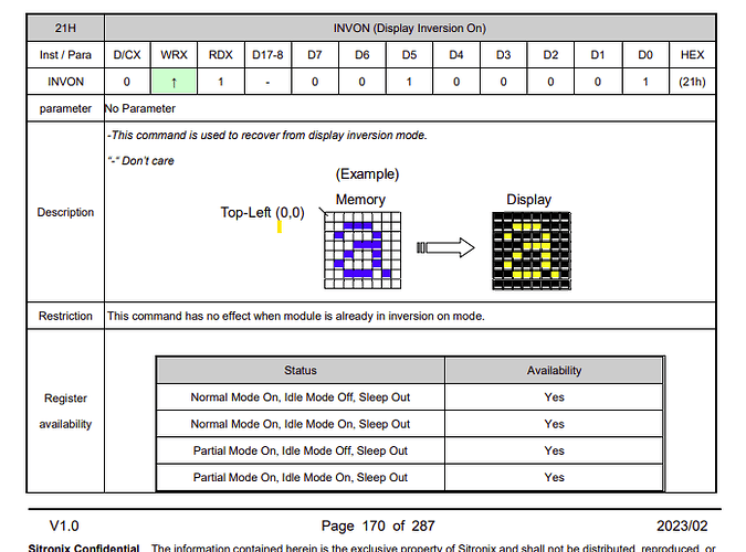

Also maybe you have to trigger inverse Color:
0x1000021
Great catch
If I can get this thing to build correctly I’ll add those in.

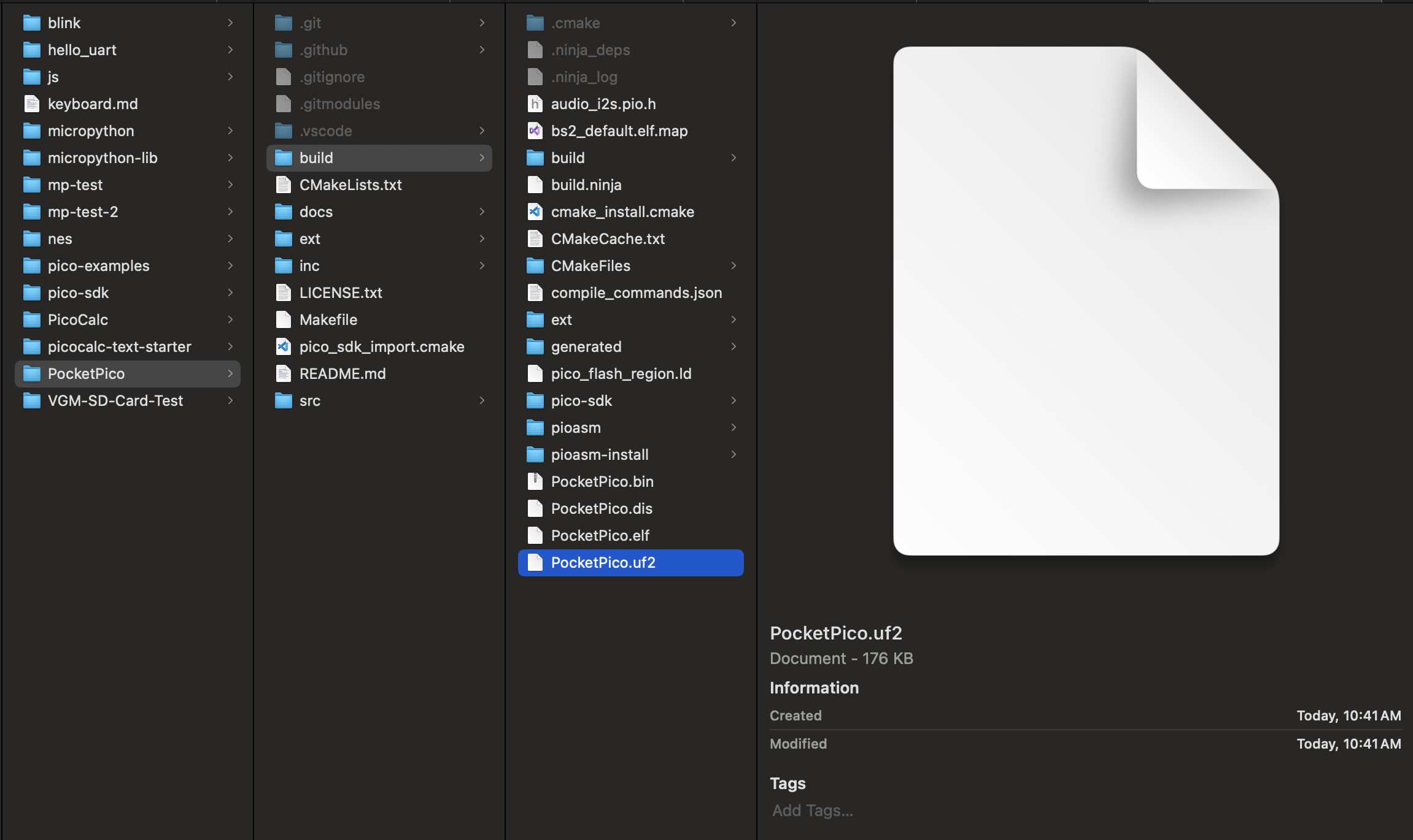

I tried on a Mac but these are the build steps (according to the documentation)
git clone https://github.com/slintak/PocketPico.git
cd PocketPico
git submodule update --init --recursive
make configure
make build
I switched to using cmake and the Raspberry Pi Pico Visual Studio Code extension
Actually, I just got it to work lol I’m not sure what I messed up last night.
I did
git clone https://github.com/TheKiwil/PocketPico.git
cd PocketPico
Then opened it in Visual Studio Code and imported as a Raspberry Pi Pico project using Pico SDK 2.1.1

I got it to build now
