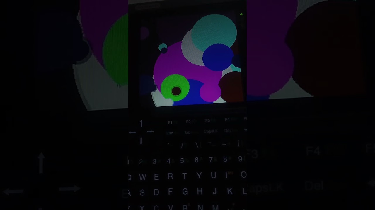

Little video. Yes, having fun :slight_smile:
It’s drawing 30 filled circles are varying speed which expand each cycle until they get a bit big then a new random one is started…
