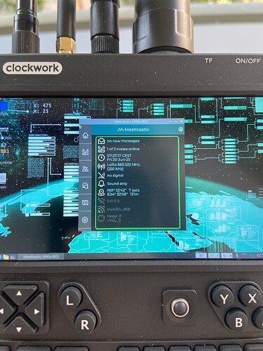

I got the map working, thank you!
Did sudo meshtastic-ui , then activated GPS, didnt get a signal, re-activating…nope..

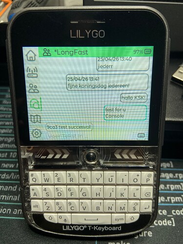

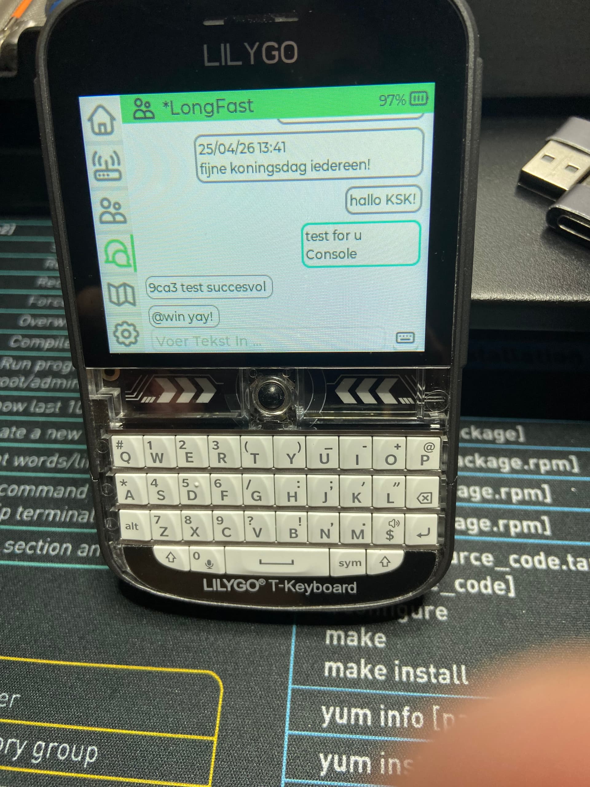

Can send and receive from and to my lilygo T-Deck,
but have to bring up the in-app keyboard and use enter to be able to send the message, you can type but pressing enter on uConsole doesn’t work.
did you enable the gps in the position tab in the meshtastic web ui?
i have to look into why the user can’t access the gps when i get a chance.
Yes, I tried everything I could think of;
  • Run the ui normal and as sudo, while trying the below
  • Activated GPS by icon, went outside for 10 minutes.
  • Deactivated the GPS, rebooted,
  • installed newest version (there was a update available)
  • Came here to cry (j/k)
