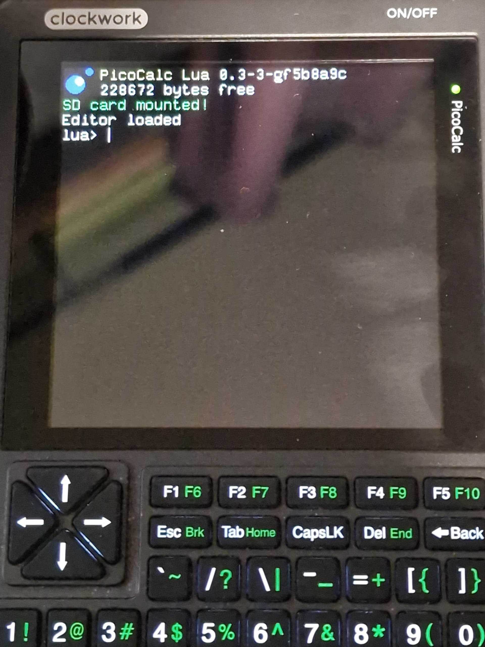

Well I don’t know what’s going on but it’s working now. I’m using this diff, but I also tried that same diff previously when it wasn’t working, so not sure why it’s working now:

The other variables that have changed are:
  1. I updated the SMT32 firmware to the latest one published by clockworkpi yesterday (PicoCalc_BIOS_v1.4.bin).
  2. I charged the battery.
i’m wondering if there’s anything i’m doing that breaks on stock keyboard firmware, because i’m also using (a fork of) 1.4
the battery thing would confirm pico1 borking without proper power, but my batteries are under 70% right now, so, shrug!

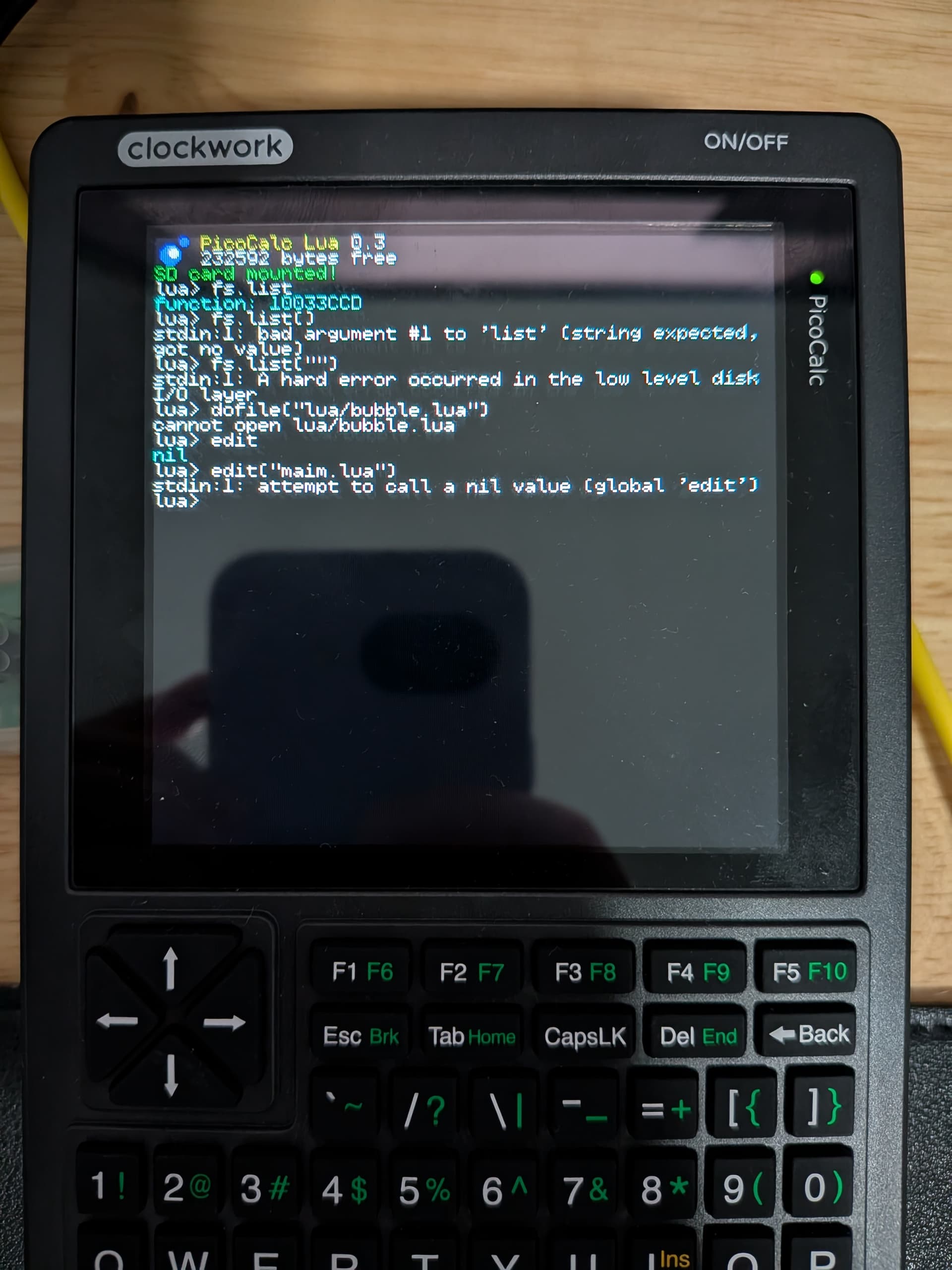

Ok next problem. I can’t seem to run stuff from the SD card, but it says “SD card mounted”
I believe the necessary files are on my SD card:
yikes! :astonished_face: i haven’t gotten that before, but i’m wondering if an erratic clock could be causing SPI issues, i admit i don’t have that good a read on pico_fatfs, but that error string means something really bad is happening (FR_DISK_ERR)
that said there should be SD hotplug, do you still get issues if you try removing and reinserting the SD card after launch, to remount the volume?
Yeah it didn’t like that:

stdin: the volume has no work area

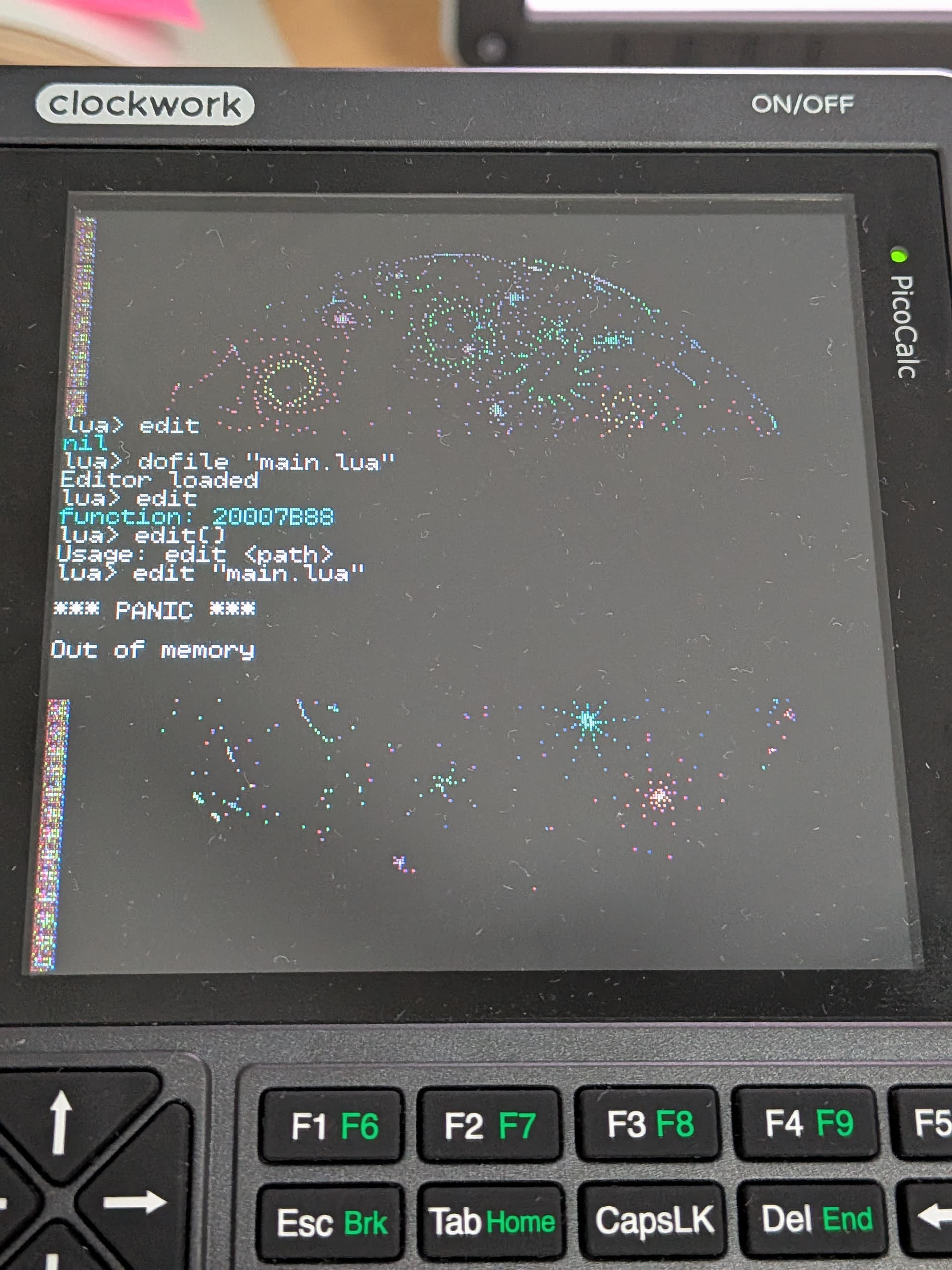

yeah, i’d like eventually to have an editor written in C outside of Lua-land but that’ll take a lot of effort. and interestingly the left-hand side garbage on the screen from the PSRAM you’re seeing there is the same i saw earlier with the non-debug build

it turns out i didn’t pay attention that the function to mount the SD card always returned a success because it has a flag for “slow mount”, which means the mount only really happened the next time a file was accessed rather than at the point mount was called, i’ve now solved that for that message not to appear unless it actually mounts :]
