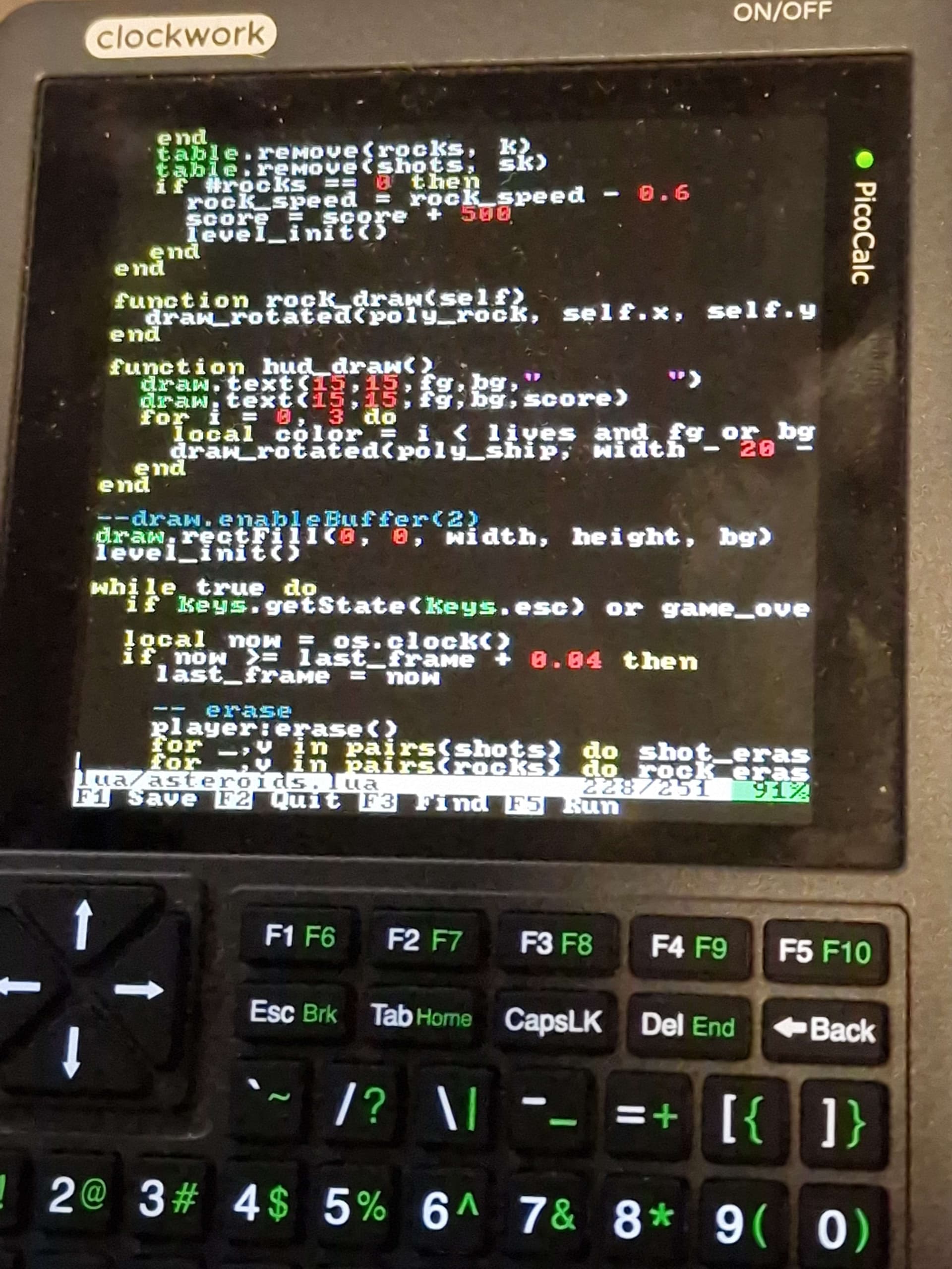

not ready for prime time yet but i’m working on porting kilo to be callable directly from the firmware, which uses way less RAM than an editor based in Lua and should work well (as demonstrated here) on a pico1

custom fonts, new text editor, oh my! new PicoCalc Lua release :]
Great job, trying it…
Keyboard does not work (not even ctrl-alt-del) and there is no flashing cursor.
