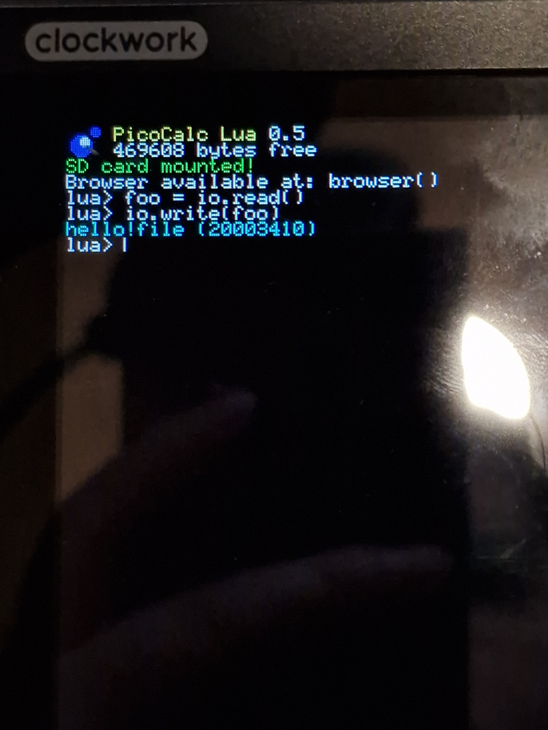

so i re enabled the io library for a test but it doesn’t quite work as you expect:
now, these (stdin not being echoed, write returning a value that gets printed along with our stdout) aren’t dealbreakers and have more to do with how the REPL is not set up like a true terminal’s STDIN, however, i wonder if it’d be worth it to modify the terminal to fit io better rather than just introduce a term input function which produces a prompt in a more custom way
let me know what you think, i want this firmware to be as easy to use as possible for people to write their own programs, it’s no fun if i’m the only one who knows how to use it :]
EDIT: i decided to go ahead and add a term.read function, since the readline code was already there for the REPL input: term: read function for text input · Lana-chan/picocalc_lua@eeb2670 · GitHub
