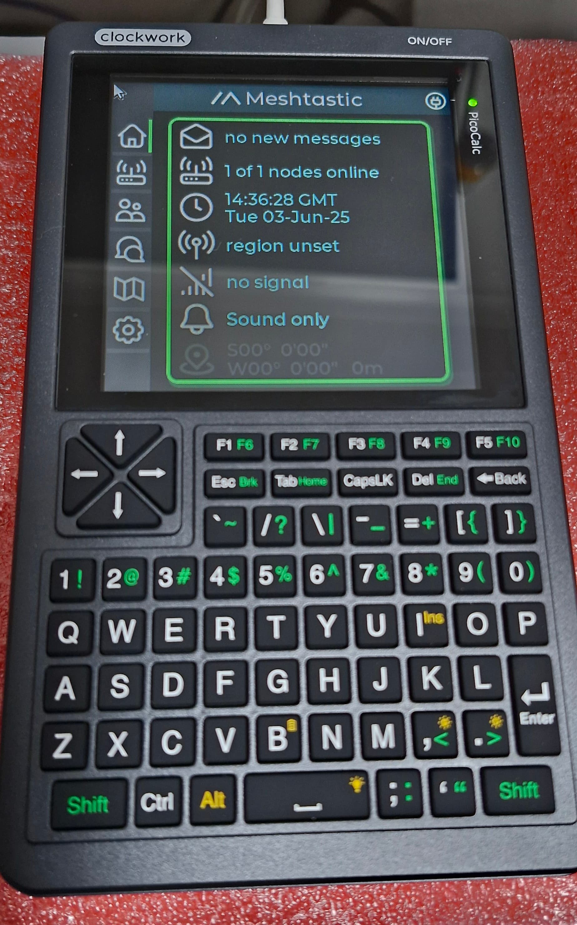

arrived today… running ubuntu 22.04 for meshtastic. (still need to review my build steps and sdk modifications) - using hisptoot drivers for keybaord, display, pwm and sound

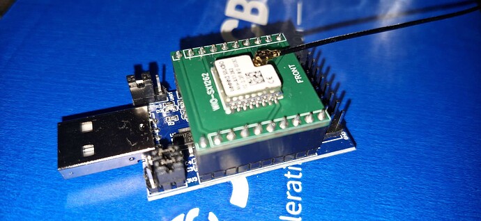

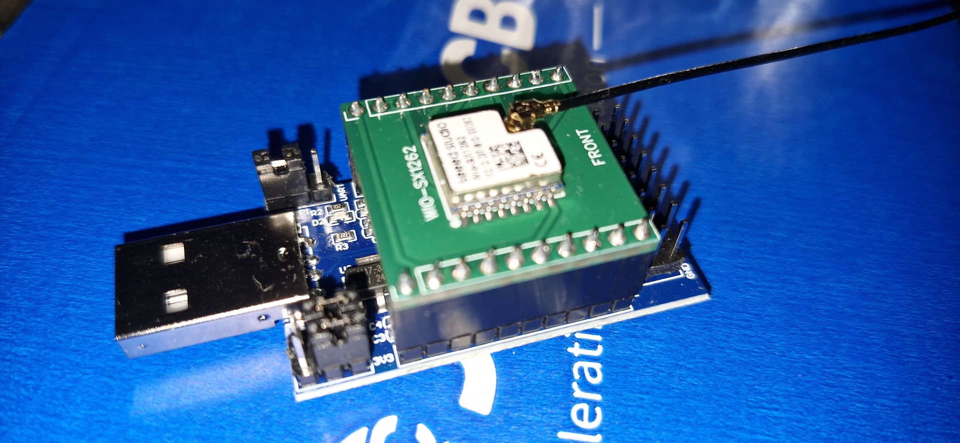

my own usb lora radio stick, until i see if i can actually get enough spi pins

Meshtastic also now can use udp and a nettwork client is already available (so you dont actually need a local lora radio just netowrk/wifi connection to other nodes)

for wio-sx1262 i need 8 total gpio
[wio-sx1262]
1 MISO
2 MOSI
3 SCK
4 CS
5 IRQ (DIO1)
6 Reset
7 Busy
8 Rxen
but other sx1262 or LR1121 will only need 7 total GPIO
or less if i use the same spi bus
