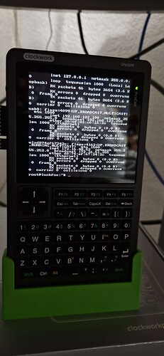

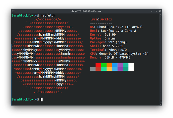

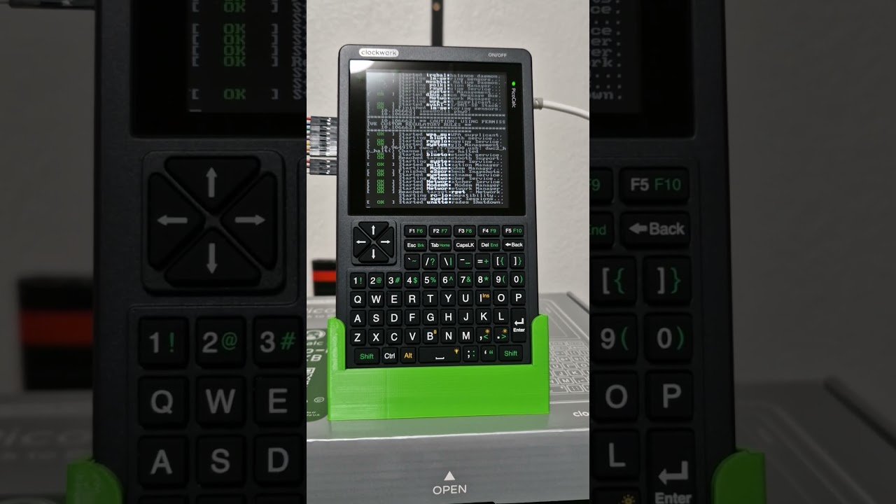

Luckfox Lyra Zero W on PicoCalc running Ubuntu 24.04.2

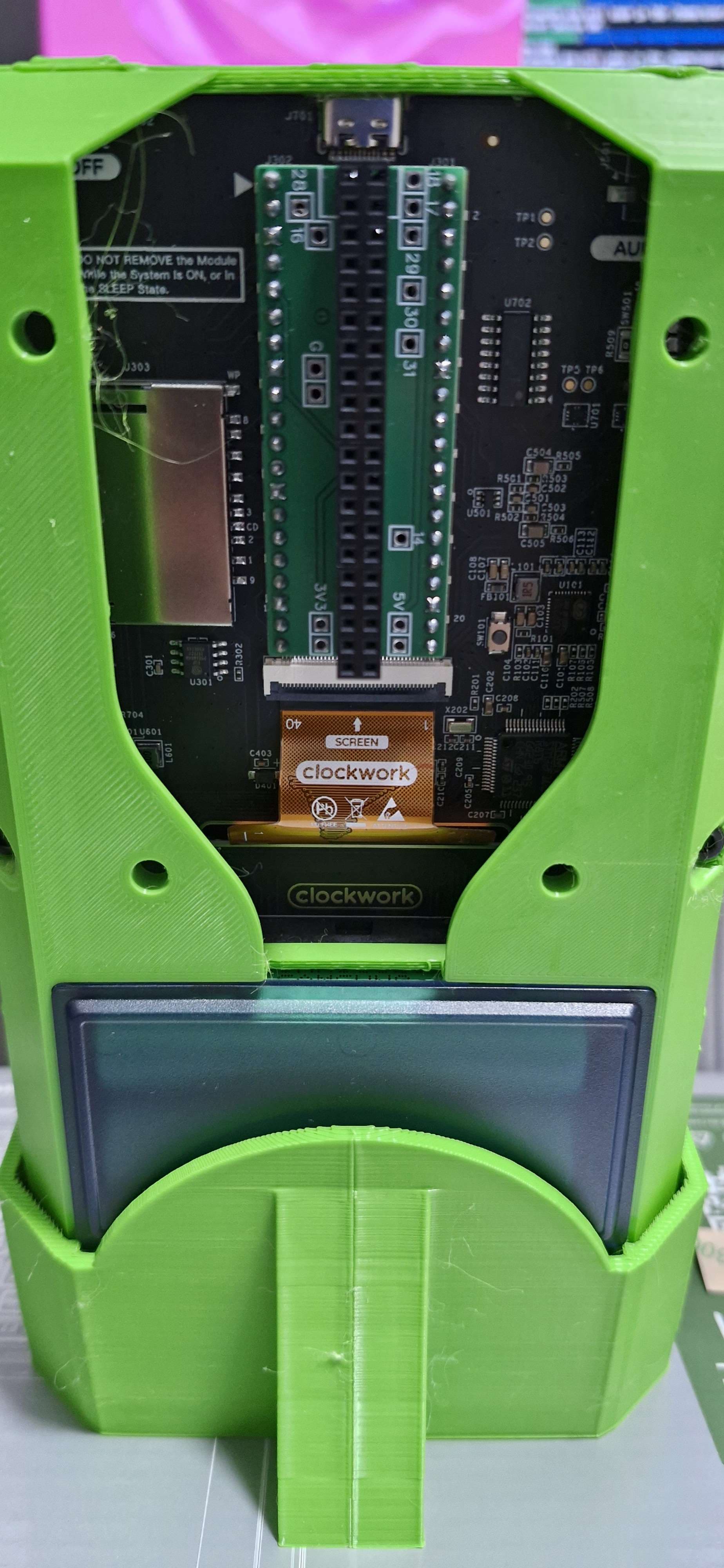

Following the existing thread for using “Luckfox Lyra on PicoCalc” - i added the Luckfox Lyra Zero W to the rear, facing down on my PicoCalc, with an adaptor (pictured below)
Still have too confirm some aspects but display, keyboard, wifi and ble ok

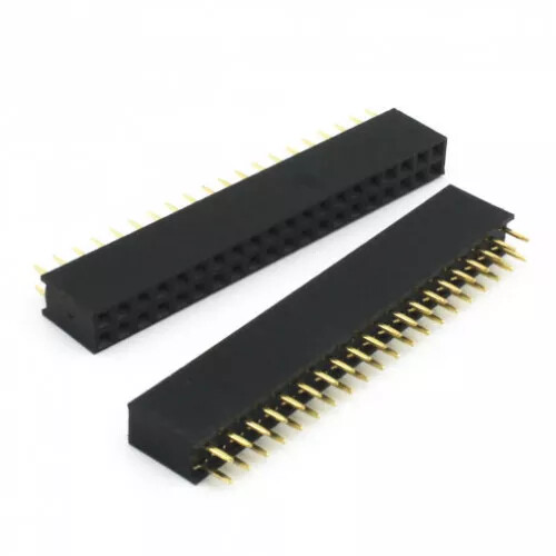

I sourced the parts here locally myself
Only needs
1 x Header 2X20 Female Connector 2.54mm pitch
1 x 2.54mm Pitch Single Row Pin Header 40-PIN - Black
broken in half
