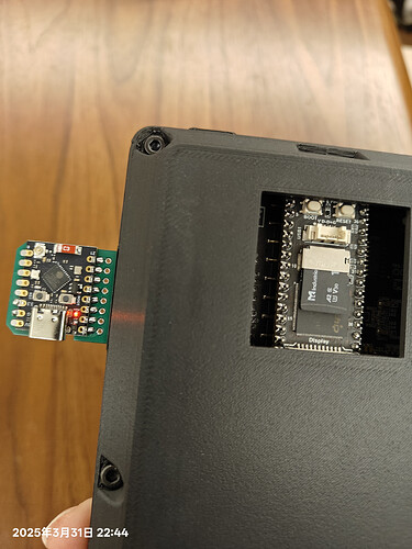

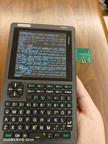

Just made esp32c3 wifi adapter work.
There is still a lot of room for improvement.

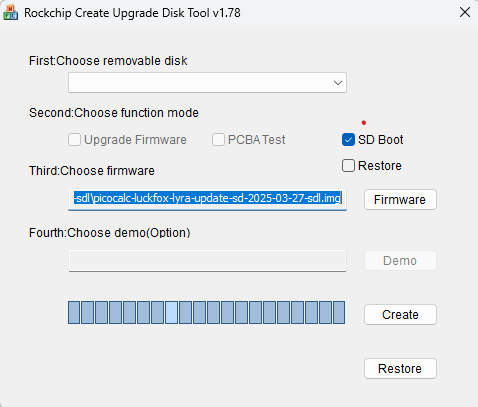

Hi, I have managed to install your image on the lyrafox and it seems to run.
There a 2 Files:
  • picocalc-luckfox-lyra-update-sd-2025-03-25-test
  • picocalc-luckfox-lyra-update-sd-2025-03-27-sdl (Is this with SDL(Graphic) support?) → Yes it is!
And there a two tools:
  • RKDevTool_Release_v3.31
  • SDDiskTool_v1.78
I have tried sdl with the RKDevTool, but this failed. Only test have worked.
I have also flashed test onto the micro sd card for the lyra, i am not sure if this make sense.
It works.
Now to my questions:
Which images is for the RKDevTool and which for the sdcard?
How to erase the SPI NAND Flash.
Thanks for your effort to bringing the Lyraboard to PicoCalc, this is great!
Update: I flashed now the SDL version to the lyra onboard sd card and I was able to play doom, great. I think you must select the BOOT Option:
BTW:
If you using the Tools, there default to Chinese.
You can changed the language in the config.ini file.
Set Selected to 2 for english
