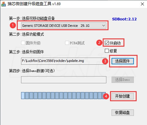

The images are all for sd card.
4.4 SPI Nand Erase
- TF Card Image Flashing
