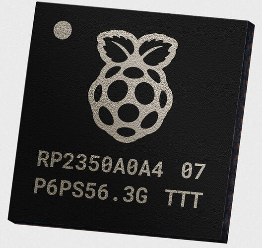

New Pico 2 on the horizon

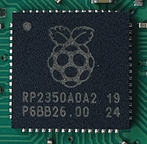

When stocks of the old Pico 2’s (using RP2350A2/A3 as below) have diminished….
They’ll be using the new A4 stepping….
This brings 5V tolerance on all pins. Security fixes. GPIO pull down resistor issue fixed etc.
There is also a new RRP2354A and RP2354B with internal flash !, yet beyond my logic it’s only 2Mb compared to the 4Mb added to current Pico 2’s !?.
Shame they didn’t improve it further….
