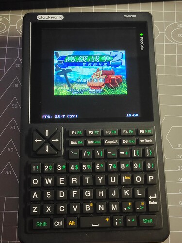

Running GBA games on PicoCalc has been one of my long-term goals.
unfortunately the default configuration of this project does not include a GBA emulator.
After some diggin to the default Makefile included in Repo and I found core of gPSP (GBA emulator) was deliberately removed. Then I tried to add gPSP back, but when compiling picoarch, if I attempted to include this core at the same time, it would cause an error and the entire compilation process would fail and terminate.
So looks like need to complie it standalone.
I read the Makefile of gPSP and found that it has built-in support for armv7L compilation (by adding the parameter “platform=classic_armv7_a7” when make).
Heres my Compilation with gPSP core:
Let me add something else here.
In the default screen driver of @hisptoot’s image, the frame rate experience is quite poor (and I think it might also affect the output frame rate of Picoarch).
He released an experimental driver. It is said that it uses the RGB565 mode instead of the original RGB666, and has a built-in 3-bit output mode witch can reach a very high refresh rate.
Based on my usage experience, even in the 565 mode, the refresh rate has a significant improvement. When using the GBA emulator and I disable all frame skipping, it can reach around 50 frames. Therefore, adding a small amount of frame skipping can basically run at 60 frames.
Press the 【Esc】 to popup menu,
Options > Emulator options > Next page > Audio Resampler = Cosine
after this,sound is working(but it’s laggy)
