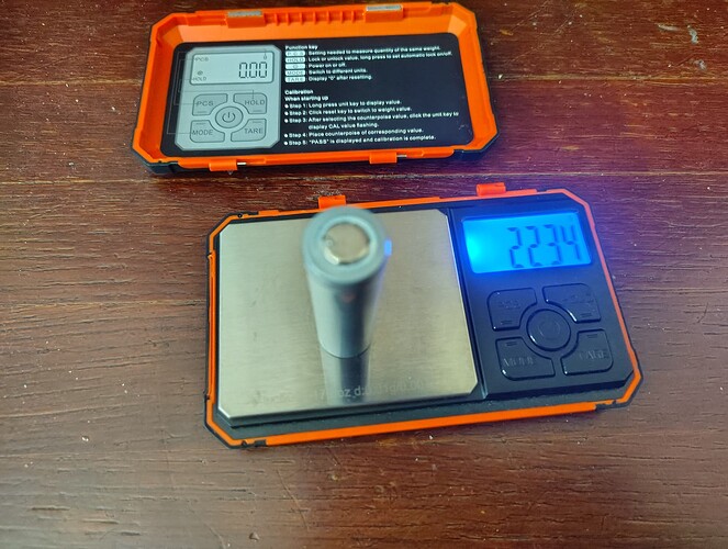

As a comparison here’s a random cell extracted from a laptop battery

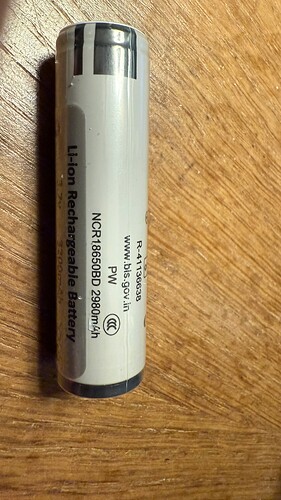

I ordered the same batteries on your recommendation and I believe I have been sent non genuine Panasonic batteries. They have no Panasonic labelling anywhere, and there are two stickers, one saying 2980mAh and the other saying 3200mAh. Did you get the same ones as me? I have emailed them, so will see what they say, but I try to be really careful with batteries.
