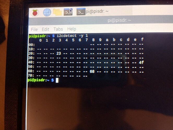

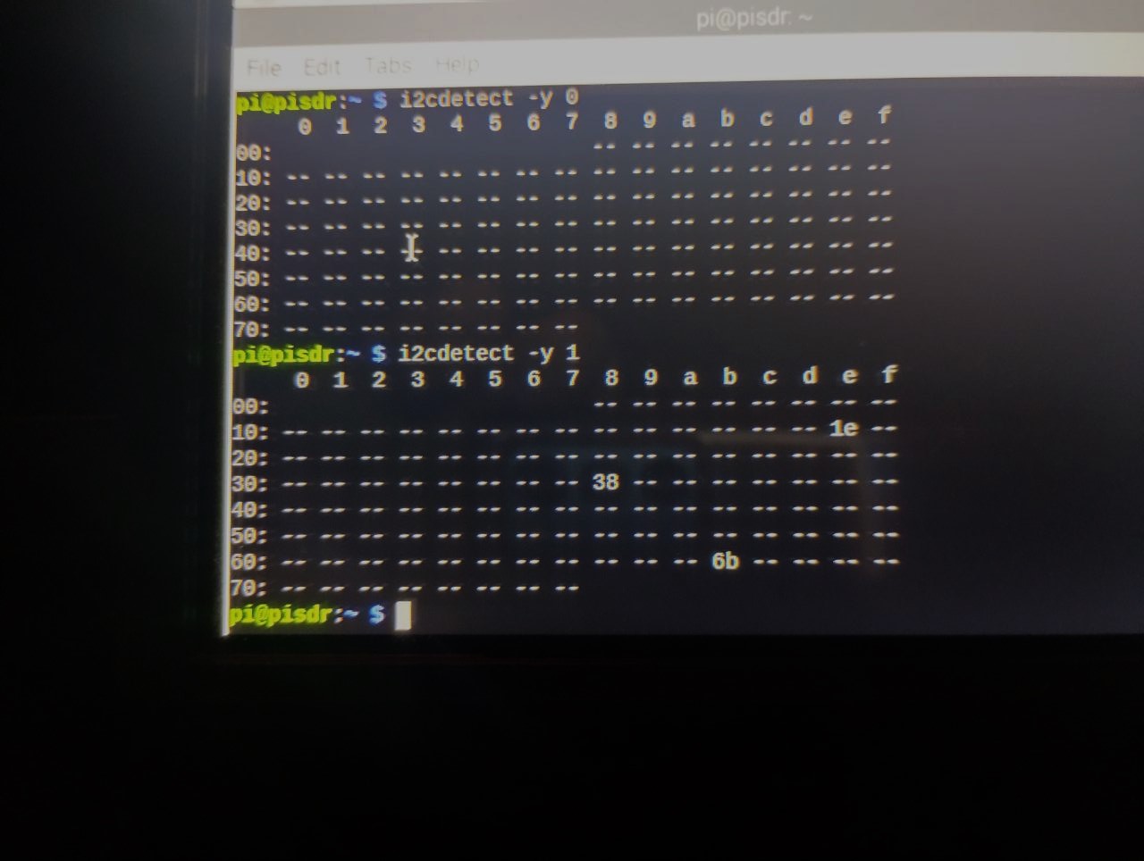

Therefore decided to first find out about the module health status. For that I am using the RPIpad which have CM4 module inside and GPIO on hand…
Good news, the module is running good and i2c bus on RPI CM4 can communicate.
Still on RPI CM4 now have full working setup. Now just to copy initialization data and the rest to the Basic…

After all that I am able to detect both boards over I2C on above RPI with CM4

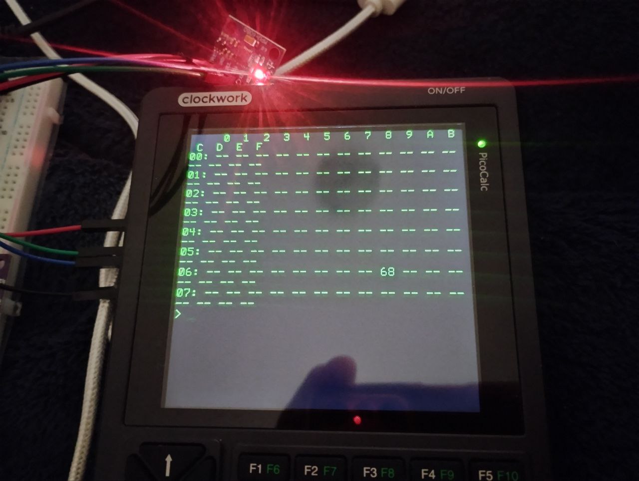

Have more luck with MMBASIC
SetPin gp4, gp5, I2C
I2C open 100, 200
Print " 0 1 2 3 4 5 6 7 8 9 A B C D E F"
For y=0 To 7
Print Hex$(y,2);": “;
For x=0 To 15
addr = y*16+x
I2C write addr, 0, 1, &H00
If MM.I2C=0 Then
Print Hex$(addr,2);” ";
Else
Print "-- ";
EndIf
Next x
Print
Next y
I2C close

After setting of proper I2c port, now have working example with MPU6050
