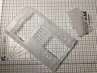

Hello,
I recently had the JLC3DP 3D printing service try out the modified data (STL) for the back cover of PicoCalc.
The photo below shows the result.
The materials are both resin (8001 resin) and translucent.
The cost was US$6 for the back cover and US$1 for the battery cover, but shipping cost was about US$14.
Shipping costs will be more expensive depending on the country and region.
8001 resin has little shrinkage and produces a good finish.
Of course, it is important to have a set of small model files to finish the details.
As you can see from the photos attached below, the finished product is good.
The cover for PicoCalc can be attached properly.
(I probably didn’t need to order the battery cover.)
If there is a problem, it is that 3D printing services are a kind of gamble.
This means that even if the data is something you created (or modified) yourself, there is no guarantee that the finished product will be perfect.
Of course, it will usually work out well, but depending on the material being printed, the fit dimensions and shrinkage may result in a finished product that the designer did not intend.
