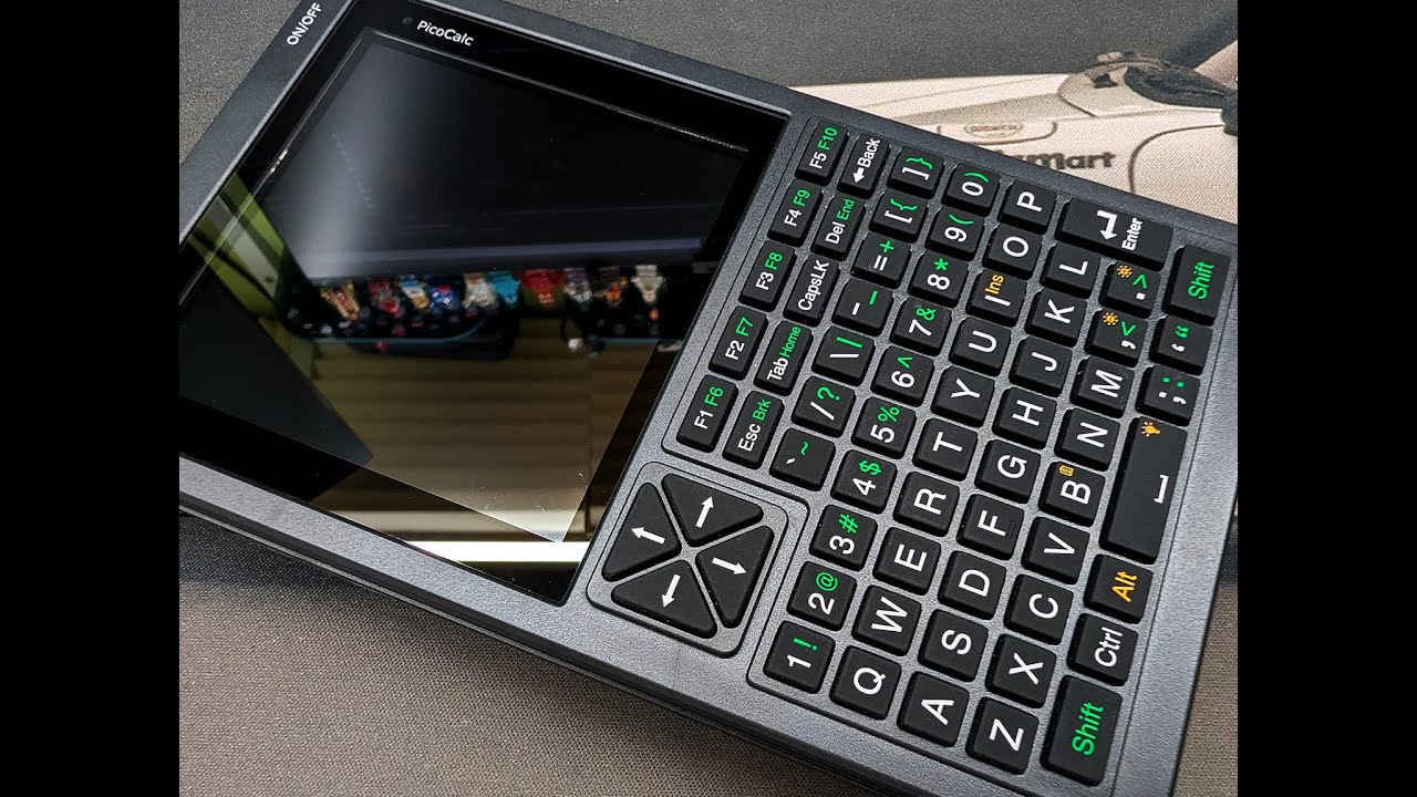

I’m noticing quite a bit of creaking around the Ctrl Alt Space ; and ’ keys and the keys in the same position on the next row up.
There’s the satisfying click when you press the key, but before the press there’s a noticeable creak. I’ve tried tightening & loosening the screws, re-seating the keyboard but not having any luck stopping it.
If i squeeze the two case elements together under the space bar it stops, but that’s no good for when I want to use it.
Anyone else experiencing this?
Anyone have any suggestions on how to stop it?

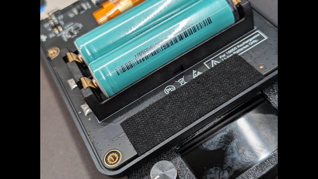

Thanks, Ben. I thought about your fabric idea for a while, then remembered I had some thin fabric tape, (for stopping creaks & squeaks in cars) I’ve run a small length along the very bottom edge of the main board that overlaps it slightly, so the lower clamshell slides past it when sealed. Hey presto, creaks gone! Have a great weekend.
This is pcb flex as it is unsupported in the bottom middle portion. To solve it, I squirted some hot glue in the gap between board and battery holder with batteries installed (while putting a little bit of pressure on the board to make the gap bigger). This will make it more rigid and reduce the flex to almost nothing.
Be careful not to scrape up the pcb as there are traces in that area.
what is this mysterious substance hot glue i keep hearing about? (for the uninitiated)
Search for hot glue gun. It heats up sticks of glue, great for some purposes.
Is he using it to fill up some space? to stop the creaking i mean?
Yeah, I haven’t done it yet, but next time I take the back off I’ll stick some in. The fabric tape has solved the symptom of the flex, but the hot glue seems like the fix to the flex itself.
